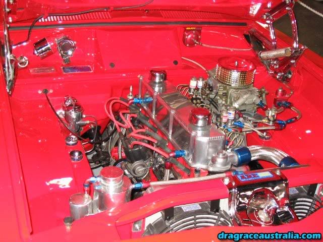

#7 _pro386_
_pro386_
Posted 13 November 2006 - 09:08 PM
How bout you go plate and fogger setup like this one.
This setup has gone mid 11's with 100hp in the fogger only. It runs 1.5 intake ratio rockers and 1.6 on the exhaust to get the exhaust percentage right for the bottle.
#8 _draglc_
_draglc_
Posted 14 November 2006 - 01:07 PM
But he asked how to do it with triples...
my setup runs 1.6 and 1.5 also...
