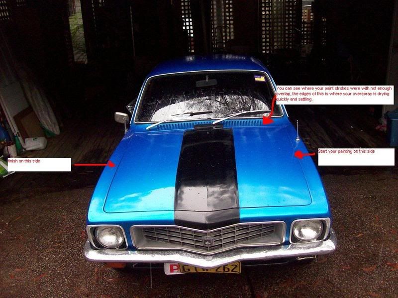

I need help!
After spraying the car, there is a line on the roof and several on the bonnet where the clear coat has gone cloudy and I cannot get it out. I've just rubbed the whole car back with 1200 and buffed it but it did not get rid of these lines. Am I not sanding enough or using the wrong sandpaper? Any ideas?
I tried to get some good photos to show the lines, but its raining and theres not much light etc etc and you cant see the full extent of the lines but they are there!
I'd like to know how it happened and also how to get rid of it as it's really getting on my nerves!
Any ideas or suggestions would be great and much appreciated!

When you sprayed the clear, what was the weather like? What time of day?
I had something like that happen when I sprayed clear and the responses from my post Clear coat gone milky suggested my problem was the time of day I sprayed and the humidity level at the time.
I am however no expert on the topic.
When I re-did my clear coat I got streaks like you have but this was different from my previous effort. It ended up being clear coat overspray and lucky all I had to do was let the clear flash off and then I wiped the panel with a tack cloth to remove the overspray. I had to do this after each coat of clear.
The end result turned out OK though.
The painting experts will be able to give a better diagnosis than me though.

Start with more sanding as a starting point, 1200 grit. Looks like a bit of overspray (painting too slow, with not enough paint coming out the nozzle, possibly air too high?). If that fails and you go through the paint, you can always start again, which is the alternative if it is due to moisture.
If it were moisture, I'd expect it to be clouded more evenly.
Do you paint using a water trap? A water trap mounted on the compressor is nearly as good as not using a water trap at all.

My opinion is the paint has been applied too dry, I dont think you'll be able to rub and buff those Tiger Stripes out too successfully.
I'd suggest a good rub down with 800-1000 wet so the surface is flat, 2 coats of your Blue Basecoat, then reapplication of your Clear.
When you apply the clear next time, Open your fan setting some more, open the fluid nozzle some more, Use more Overlap than you did last time and lay it on really wet, Acrylic is really hard to get a run in particularly on a bonnet so don't be scared.
Most importantly I'd also suggest going for a better quality thinners too, theres a lot of dry spray there which means the paint is drying in the air before its hitting the panel. Some Retarder Thinners will help slow down the drying time for the paint also but use sparingly.
If your painting it again and experience this dryspray you can always give it a quick coat of straight thinners to try and melt it into the paint surface while the paint is still drying.
Another tip for bonnets/roofs, Start on one side of the panel and work your way across, particularly with Acrylic Lacquer if you start in the middle of the panel and work outwards and then come back in the middle when you do the other side you will get some dryspray there.
Don't get discouraged, no one is having a go at you, it's great to see a young bloke giving it a go, have another crack and it will work out fine!!

Looks to me like the base coat has been sprayed on like a solid paint , did you use a criss cross pattern when doing the metallic base or spray it on like a solid colour. This will give it a milky look on top but you problem will be the base colour. There is only 1 way to fix this problem and that is to rub back with 1200 and relay your base evenly, just my opinion but

You can also get that effect when you hold the gun at the wrong angle, you need to spray the bonnet and roof with the gun spraying at 90 deg, so the fan pattern is even, if its the wrong angle then you will most likely have the bottom edge of the fan pattern spraying to heavy in to the panel and the top edge providing you with what you think is a good coverage but the bottom edge is to heavy and causing this pattern, this is more likely to be the case than dry spray as the dry spray would usually be a wider area. I am unsure why the heavy edge will do this maybe from airating the clear coat where the heavy edge of your spray pattern is, similar to pouring water in to a bucket only then you will see larger bubbles being forced under the water.
Alot of learner painters will do this because it can be difficult to hold the gun over horizontally level.
Thats my theory and as I am well and truley over it, im sticking to it.
start at one side working in to the middle and then go to the other side of the car and start at the middle and work back towards yourself. with metallics after you have got the coverage that you want, it also helps to do even dust coats over the car from a bit further away to get all the metallic excited, it will look lovely and cover up areas where (if) you have the metallic uneven for any reason.
Make sure its not cold outside when you spray as the acrylic paints will go milky or cloudy from the cold, also larger areas than your stripes, this is with straight colours or clear coats.
Always make sure your gun is clean and spraying a nice pattern and make sure the breather hole in the lid is clear and not blocked, it also helps not to have a full gun doing boot bonnets and the roof, make sure if your lid moves that you set it with the breather hole closest to the handle of the gun so when your spraying the bonnet the breather is up at the top of the lid to prevent dripping from the hole.

i am a spray painter by trade so i might be able to shed some light on the situation if it was painted in acrylic then it couuld be in the base coat but it looks like it is in the clearcoat the cause is either to thick of a pass on the clearcoat (usually happen when you go for the flat glass look) or the day when you painted it was to cold causin the clear to bleamish
if it was painted in 2 pak then it looks like it will be in the basecoat where you have had dry spray usually on to hot of a day
just post up what type of paint you used and what type of day it was and i will figure out cause and rectification for you
