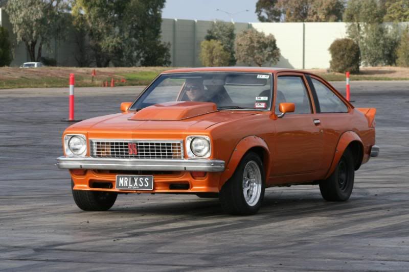

This was my car with
225/50/15 Tyres and KHFL-14
I am hoping that the A9X lowered ones are lower than these ones 15-20mm would be spot on for me.
The ones i have in now are modified and too soft for my liking.
But I'd like to be around this (current) ride height.

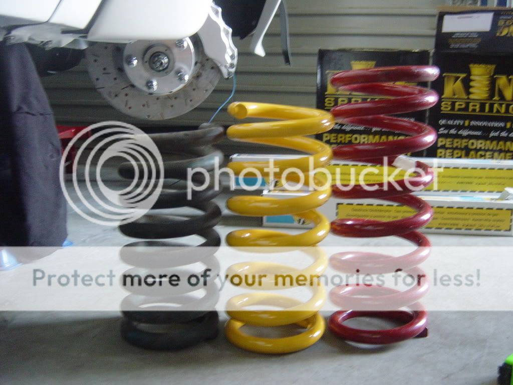

theese are pretty much the 3 sizes u are looking at.i just remeasured them exept the yellows.they are in my car
red spring=pedders standard 330mm long
yellow spring=king spring khfl-14(2 inches lower than standard.pretty sure it 280mm long)
blue spring=lovels 255mm long (this was in my hatch when i first got it.running 14/50/245 bf godriches.the wheel was similar that last photo,nice and low.u could hardly get a jack under it)

Thats a good pic of the springs... I wonder what the A9X springs look like...

the A9X spring will be between the blue and the yellow.im pretty sure it was about 10 mm higher than the lovells spring.if im right the A9X spring will be 265mm long.thats from
memory.
if u want u can trial fit my 255mm long ones

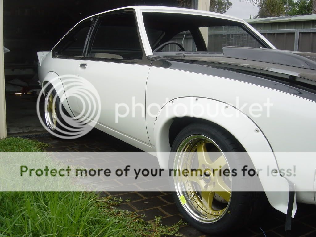

Matt, yeah I now run the King Springs standard A9X spec springs with HQ stub axles.... regarding this photo you posted earlier:
That shows Pedders springs compared to my stocko springs. These Pedders were replaced for the King Springs... which had more coils, and were slightly taller from memory. I do have a photo of them sitting side by side, but it's not on my PC, it's in an old photo album at home.
