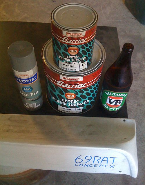

#33 N/A-PWR
  • 9,639 posts
Posted 21 July 2014 - 01:16 PM
We also use 426 Etch Pro (PROTEC) grey spray can,
straight away on bear metal surfaces.
Then use EPOTEC 408 white when all is ready later:-
