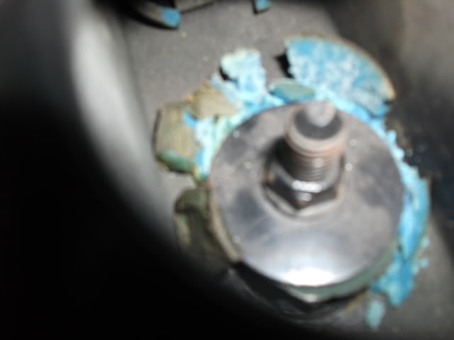

Here's what's left of the Noltec bushes, i can't believe i drove the car to WSID & ran two passes at nearly 190kph, then drove it home with the suspension like this.
Just as disturbing is this.
A hard lesson to learn but i count myself very lucky the car didn't end up causing an accident & possibly injuring or killing someone. Another item to be getting attention are the balljoints. Eight years ago when i first rebuilt the suspension i fitted lower balljoints & tierod ends with nylon thread locknuts, all have come loose & will be replaced with castleated nut/splitpin joints. Mind you this car wouldn't have clocked up more than 500kms since the front end was built.
