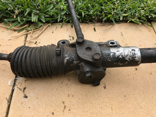

Posted 15 July 2020 - 07:23 AM
Just like this.Attached File  20191204_102753 (600 x 450).jpg   81.61K   7 downloads
