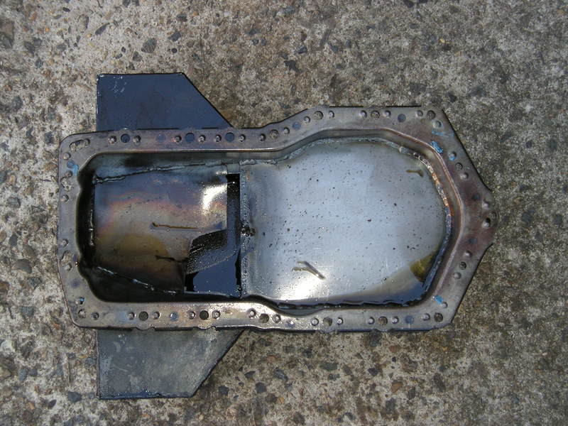

I made my own... not that hard if you're handy with a welder ..... I used Holden V8 engine mounts on my set up, where as the other guys use 6cyl ones.
And did my own sump..... but I did have a dummy eng and gear box to put in and out a few times.....
The sump
The sump

work of art how come paris havent phoned up mate asking for it to be next to the monolisa?!

Yes that is very good. Did u make your own engine mounts aswell.
Could you post up as many photos as possible of the engine, gearbox, interior photos of how much longer the gearbox is compared to an old one. etc.
