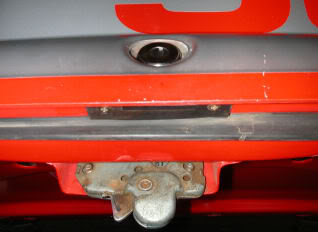

With my UC and i'm pretty sure its similar with LX you can unscrew the lock retainer tab from underneth the boot lid. Just drop down the number plate flap and look up should be 2 screw on a U shaped tab holding in lock. Get them out then its a matter of trying to pull the lock mechinism out. This is how i changed boot lock on the UC when i got it anyway.

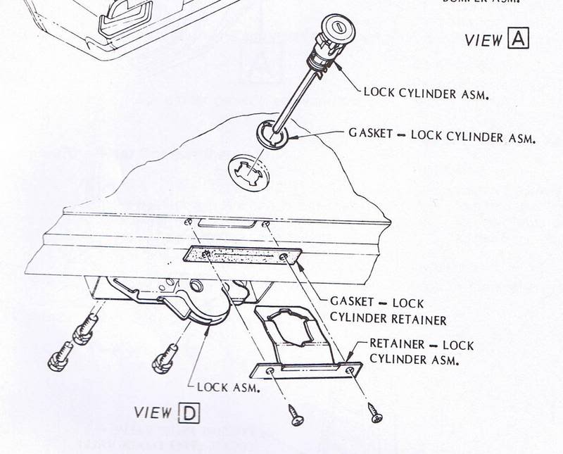

This is the LH lock assembly. On the HQs you can undo the 2 screws holding the retainer and remove the lock.

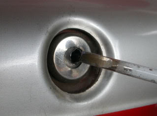

This is how I had to do it on the stuffed one on my old a9x...

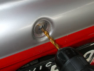

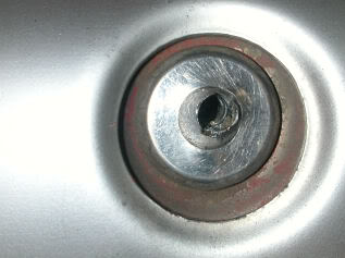

Drill out the lock till you get to the gap (pretty sure this is still the same for LC/LJ)
Should look something like this:
I used a anglegrinder to make a small slot head screwdriver that would fit inside the hole I drilled...
To remove the lock do what was said above and remove the two self tappers under the bootlid...

Thanks gents, Yeah, the LC lock is exactly the same as the LH diagram pictured, I have removed the lock from the boot before, but not while it was closed :P
Flamenco, Thanks for that. I'm not sure what it is you do with the flathead to turn the mechanism once the lock is drilled out.. Perhaps can you PM me?

The flathead screwdriver is just used to turn the latch... If you see the diagram JBM posted, the flat rod coming out the end of the lock is what usually turns the centre of the latch.
