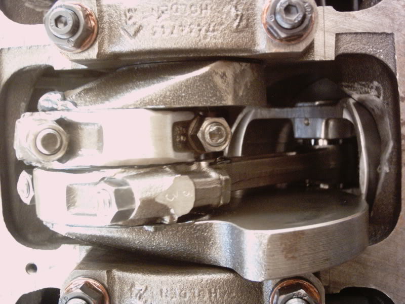

I have a vn rodded harrop crank 355 red 308.
It only required minor die grinding at the bottom of the bores to clear the rod throw.
355 bottom end pic

Some of the 5 litre Holden blocks are cast with the bore relieved for a 5.7 litre (355ci) stoker engine so no grinding is neccessary unless you want to go bigger in capacity
When HSV introduce the Holden 5.7 litre (using the Harrop crank) all Holden V8 5 litre blocks from then on were cast for use for a 5.7 litre crank regardless whether they were used for a 5 litre or 5.7 litre engine.
