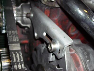

due to the gilmer drive i dont have room to fit an engine fan or even a thermo fan. so i had to fit a thermo fan at the front of the radiator and blow through it.
this pic is before i fitted the VL bracket

nice looks like youve almost completely run out of room like me. whats the go with the vl braket any special type of bracket. i will get one straight away those 202 ones flex a fair bit!

Just a question, If your doing the belt up so tight that there is flex in the alternator brakett, do you really need to do it up that tight?
The belt and gears have teeth, its not like they will slip easily like the standard fan belt will if you don't do it up tight enough.
Steve

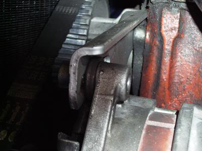

gilmer belts still have to be pretty tight ive noticed, if its not tight enough it makes a reallllllllllllllllly nasty noise then the belt skips
here is the VL bracket "in action"
Edited by why-psi, 04 April 2007 - 07:17 PM.

you should just runn twin holden 6 brackets as per xu-1 bathurst specs..... solved my altinator flex problem... you need a longer bolts tho. but thats not a drama...

yea ive heard of that too, this one is stronger though

Ben - No Probs what so ever fitting the desert cooler in with the gilmer. As for belt tightness these should be able to be turned through approx 90 degrees, so they don't really seem to be all that tight, If it slips it must be extremely loose.
The VL bracket looks sweetand strong although I still run the standard bracket and don't have troubles as the belts don't need to be that tight, unless you want your gilmer to really scream, as the tighter it is the louder it is :D
