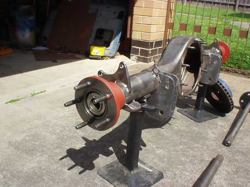

I'm going to use floats hubs and axles on the rear of the lc. Whats it worth to set up a 9inch? And what brake setup and handbrake can to uses.

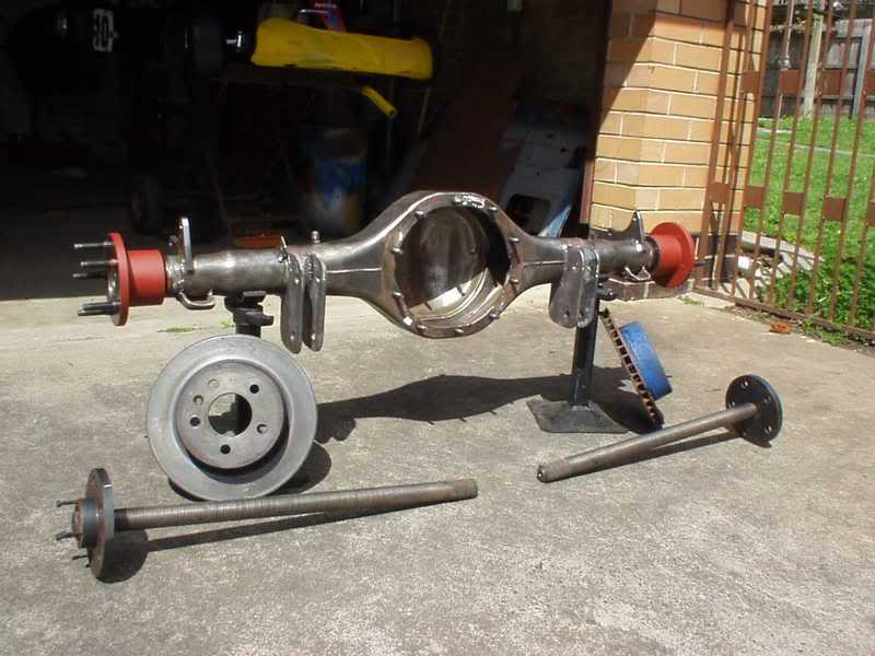

This pic shows Welbys floating rear setup
It uses Commodore handbrake mechanisms and disc on an A9X Sailsbury

After twisting the 28 spline 9" axles in my Chevy l had a 31 spline diff with floating hubs made up locally. Brakes are XB discs and calipers (l think) using standard Chevy hand brake cable. The cost about four years ago was $1,400 with me supplying the housing and brakes.
Work was done Mat at Langwarrin, PM me if you want his details.
