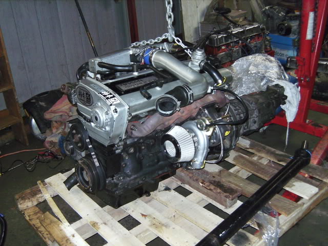

#12 _hatcheddan_
_hatcheddan_
Posted 04 August 2007 - 06:43 PM
I'm considering selling my set up, complete turbo rb20 motor, sump, engine mounts (to suit LH to UC) , new turbo, 5speed, heavy duty clutch, tailshaft to suit BW, gear box cross member, microtech computer tuned and ready to go c/w hand controler, has made 200rwkw with old turbo, if any ones interested pm me :D
cheers, Dan
