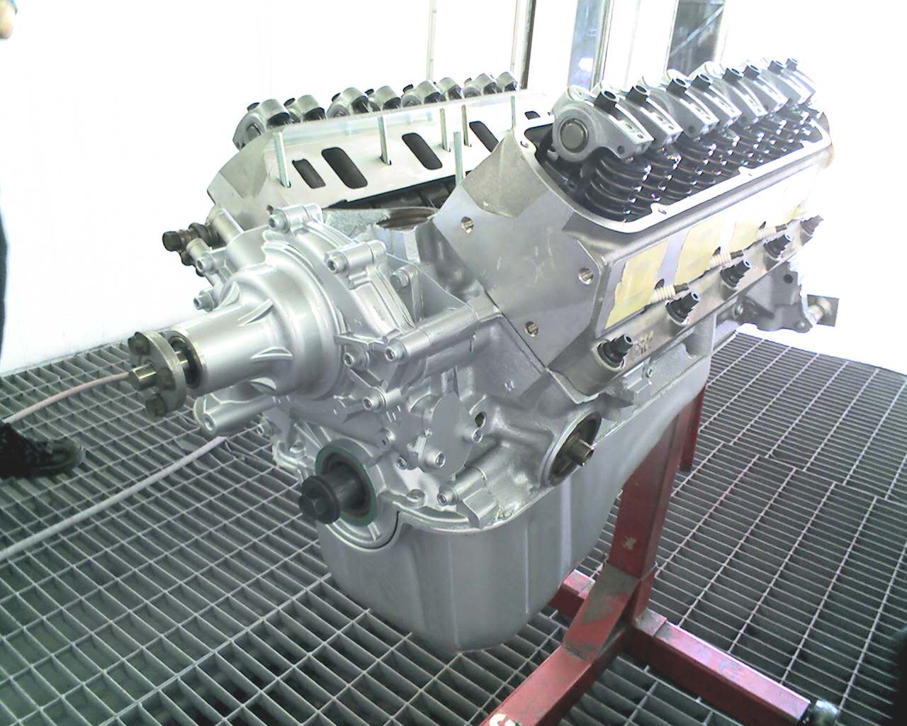

Normal automotive 2pack paint holds up well and the advantage is you can mix it any colour you like. I painted this motor sometime 12-18mths ago and it still looks good in the car today.
It needs to be super clean and you'll need to use a primer that can be painted "Wet-on-Wet" on first and of course have the usual 2pack painting equipment.

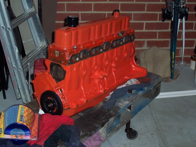

Heehehe...well im about to drop in my freshly painted 202 in this weekend...i painted it with the septone engine enamel that you can get from supercheap about $14 a can.
is that the sort of stock look your goin for? Its been sitting in my garage for some time and seems to have cured quite well so i think with the septone you'd be right to paitn it and leave it for a while. I just made sure that i scrubbed all the grease off it well before paint.
**OHH BTW if you asking dont flame me for the pod hahahah, its for the gas research carby!

haha! yes thats the look im after! that engine looks mint! top job! will be interesting to see how well the adhesion is ey!
