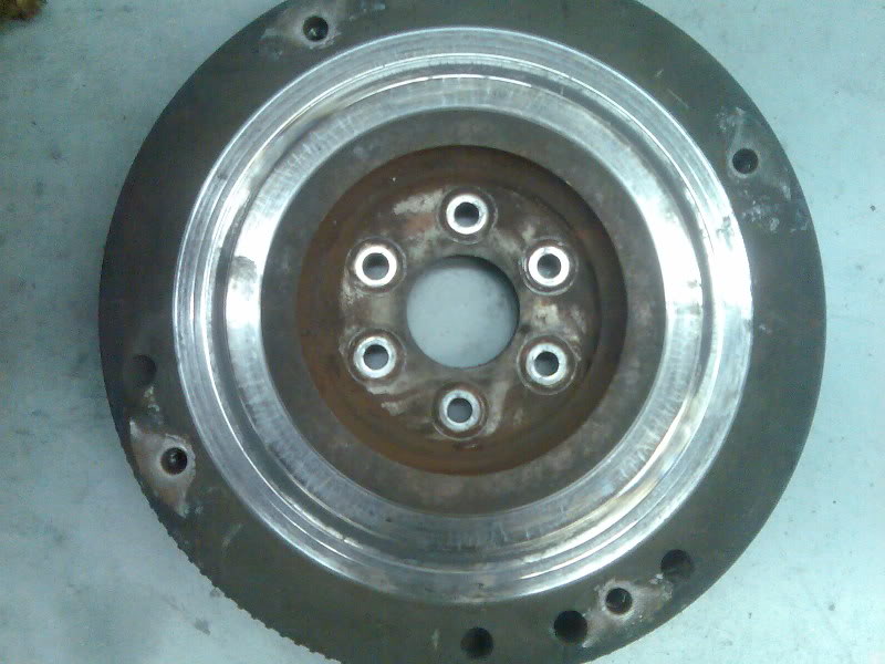

I arranged one recently for a forum member and asked the engine builder how much can you take off? He said .060". I think the gain would be hardly noticable. Cost to machine was $30 (I think? he picked it up and paid for it)
but to take .060" off was going to cost more.

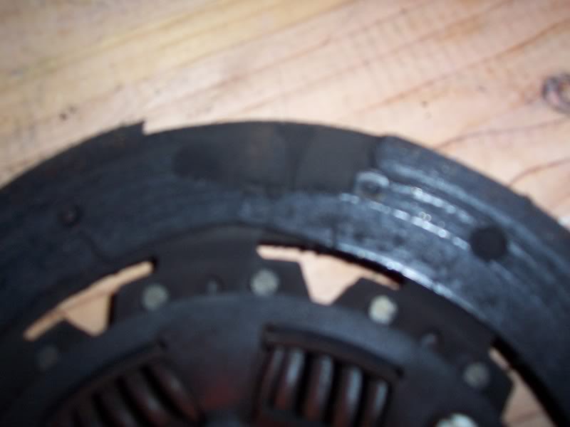

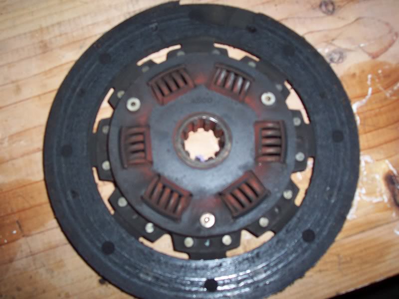

Ya that was me...i mean, my 202 is pretty mild so i wasn't really in need of a super light flywheel, but i just wanted something slightly machined (for peace of mind i spose lol) and with a nice clean surface for my new clutch rather than one with grooves and heat/stress cracks from a clutch pad that looked like someone had taken a bite out of it (yes...there was a peice missing! And i was still driving it to work/uni! :rockon:. (i have pics if interested, some people say they dont know how i was still driving it). But i can only compare performance to a rooted 173/3spd man but i think it seems to spin up nicely...once again cheers rob, helped me to get a flywheel that was perfect, just in time :spoton: . Makes for really smooth gearshifts, love it. Dont go too light, jsut a nice surface for the clutch should be fine

LOL well....you dont want to end up with a flywheel and clutch like THIS!
grooves were very defined
mmmm tastyyy
:rolleyes: nice huh. Was still driveable...with alotta slippage tho...i think heath remembers all too well :tease:
Edited by Brad1979UC, 12 October 2007 - 12:21 AM.

Thats not a clutch................more like a torque converter. High stall at that! :blink:
