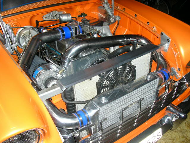

cheers for that, Its a efi black 202 with a v1 or v2 vortech with 25psi? and running methonal i think thats about it :P
heres a pic :)
