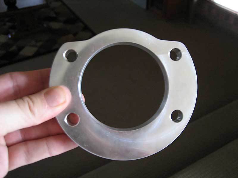

I've recently purchased a RRS rear brake kit and the above photo is the spacer that is included in the wide bearing variant (the spacer is �" in thickness). I've been trying to decide which is the better two of the options, wide or narrow bearing axles.
I'm getting conflicting information. I've been told that wide bearings tend to wear out axles. Apparently it's common on rear disc ends.
Does anyone have any other information on either setup?
Thanks.
Thanks.
#6
Posted 06 December 2007 - 04:01 PM
Hi antelopeslr5000.
IMHO the weak spot in a Ford 9" rear end is the axle bearings.
The narrow ones are just acceptable, while the wide ones are sh#t.
In Aust Fords, the wide bearings were only fitted to XA, XB & XC rear disc braked cars. All Aust Ford rear drum 9" cars used the narrow bearings.
If you are doing a conversion use the later model (Holden or Ford) tapered rear axle bearings. I know it's more work, but the end result is a bulletproof rear end.
Dr Terry.
Dr Terry.
