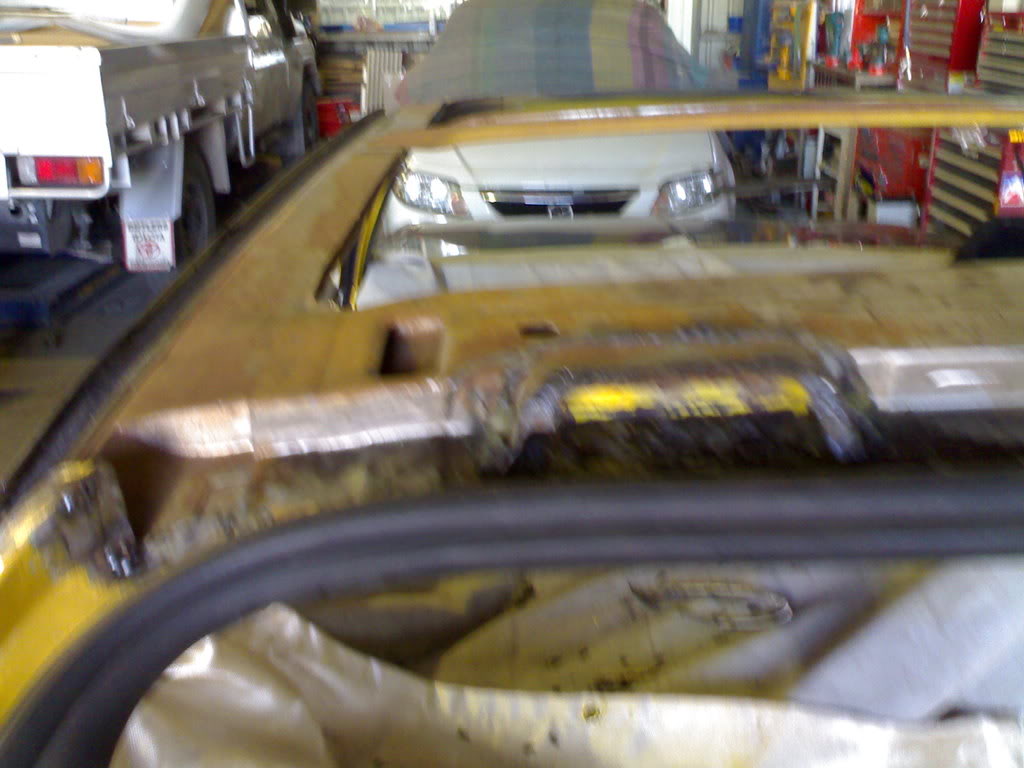

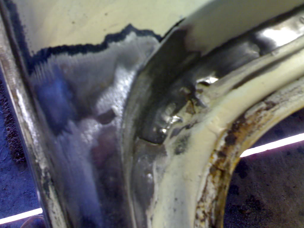

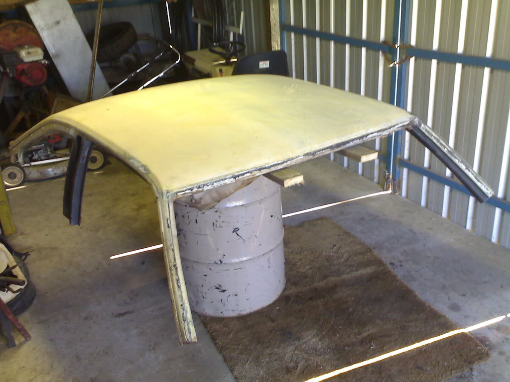

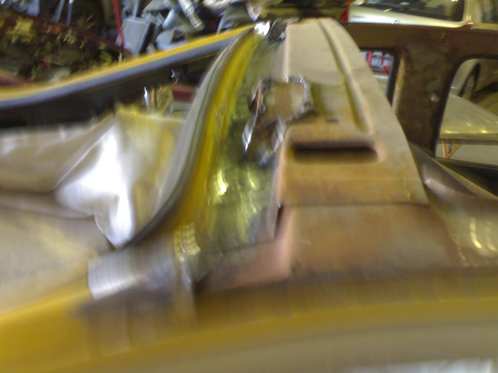

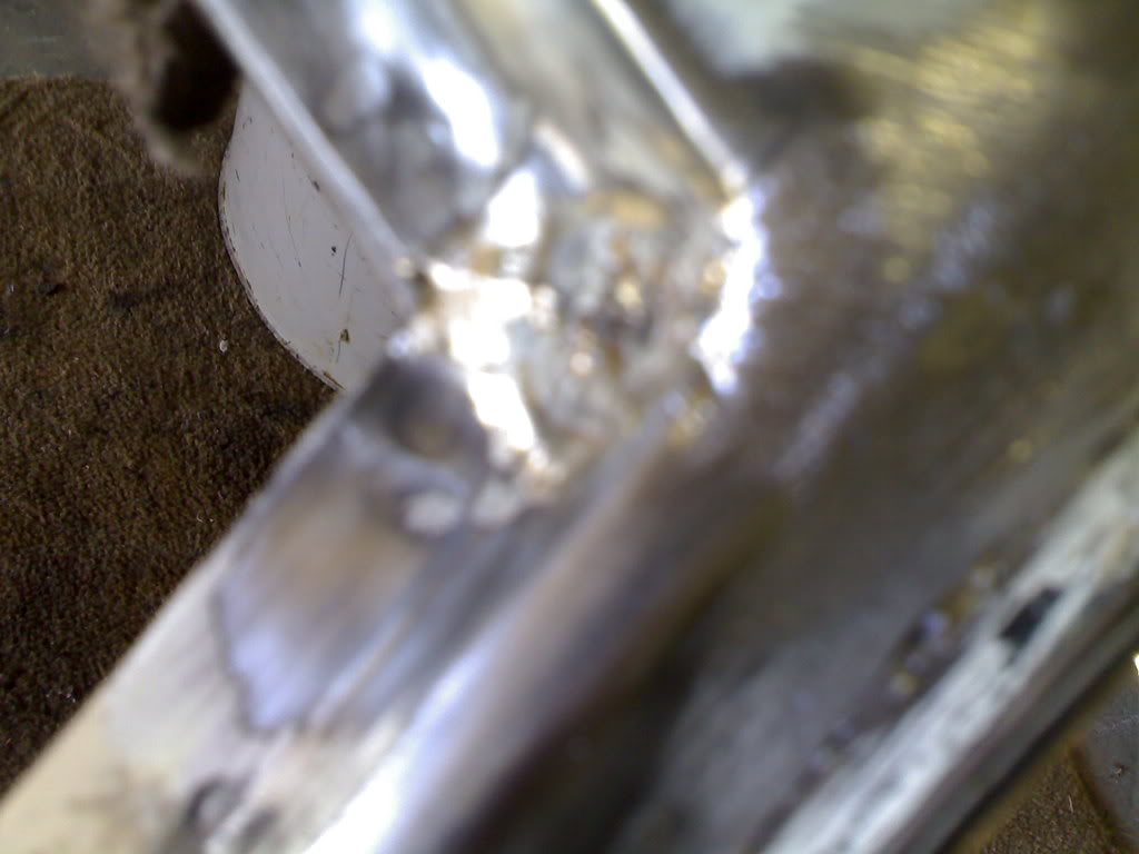

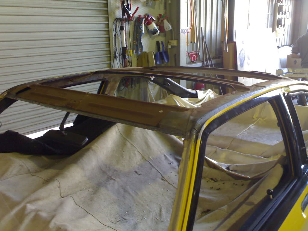

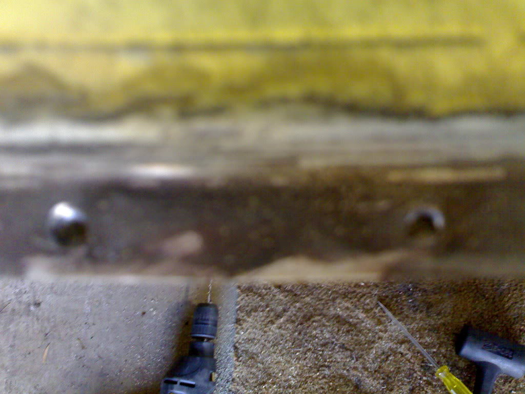

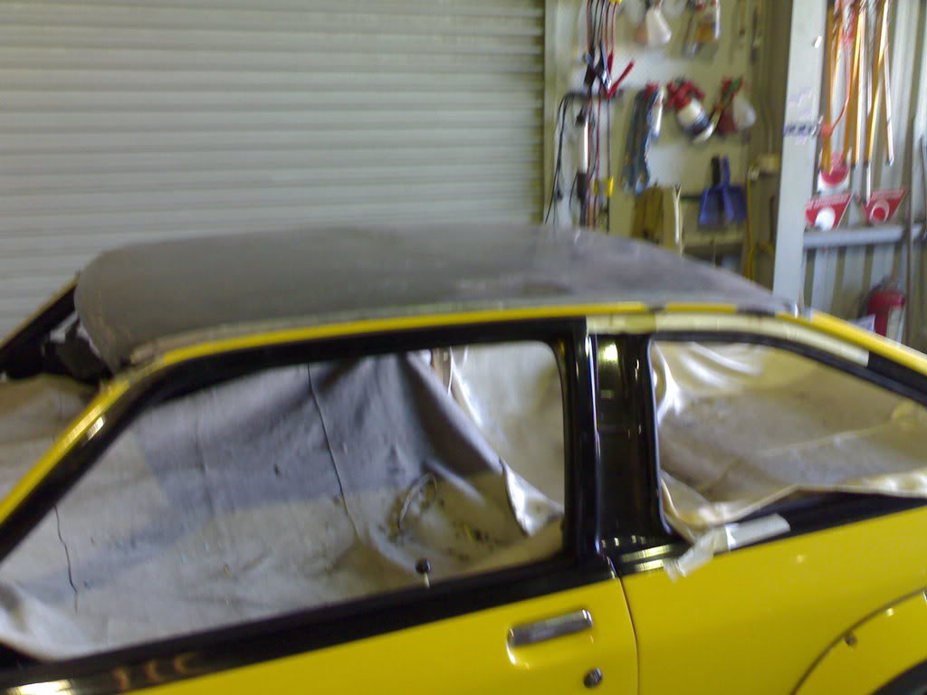

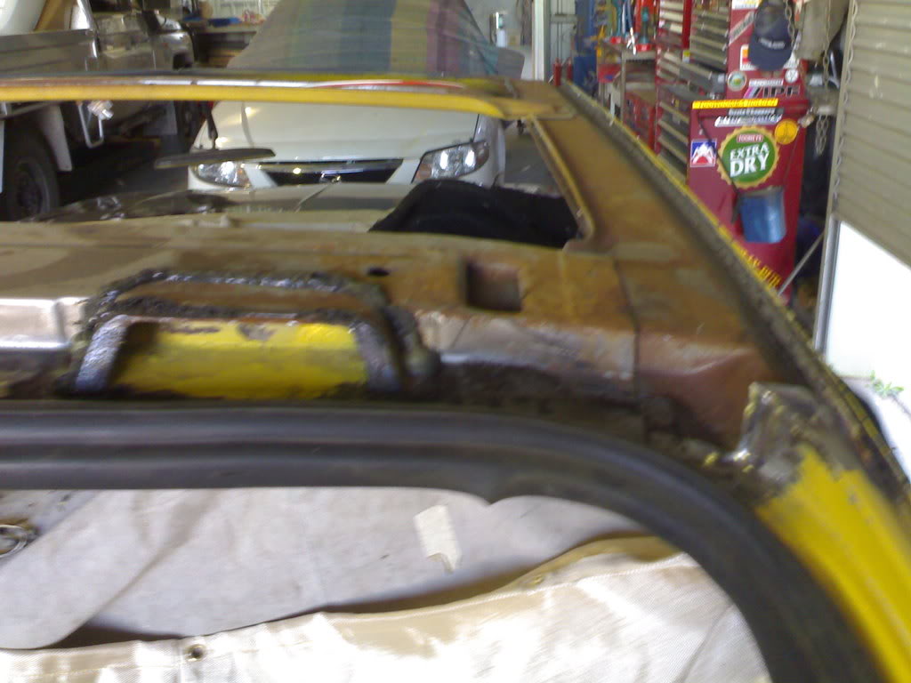

Some pics of the skin replacement I did.

Sorry,not the best photos as they are off a phone
