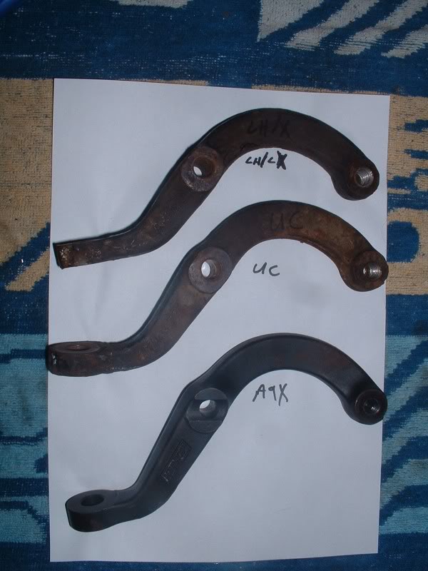

You will finds pic's of the steering arms in this thread.
http://www.gmh-toran...showtopic=14102
I am not sure that fitting UC arms with HQ stubs will achieve anything worthwhile.
#3 _rorym_
Posted 27 December 2007 - 04:51 PM
Compare away! The LH ones are noticably flatter on the knuckle end.

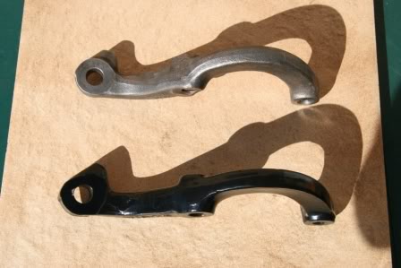

Can you post pictures of the arms you have. A view from the top will make it easy to identify.
LH/LX top, UC Bottom
Note the UC arm is longer than the LH/LX
Pictures from this thread

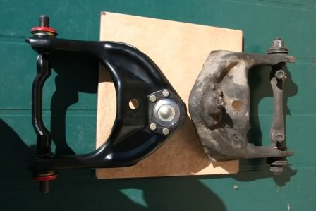

If the front end was UC it should have had offset ball joints on the upper arms. The UC arm is painted. Note the offset of the ball joint in relation to the bump stop hole.

Hi ls2lxhatch the 2 arms in your photo look the same to me but i could be wrong. I have taken photos but i don't know how to add them too here.
Rorym thanks for the pics. Both my sets of arms look like the UC ones. But i believe that the ones on my LH have never been changed.
