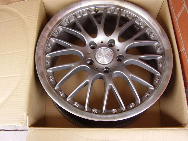

#14 _Herne_
_Herne_
Posted 18 January 2008 - 03:56 PM
Here is a photo of the rims I obtained from my son for my VP.
The size is 18 x 8.5"
The reason he replaced them was because the old ones need refurbishing, a job that I will have to look into but at $400.00 the set including gutter scrapes I guess it's not too bad a deal. He is prepared to wait for the cash as its going to be a few months before I can pay him, I have other commitments due to my Torry.

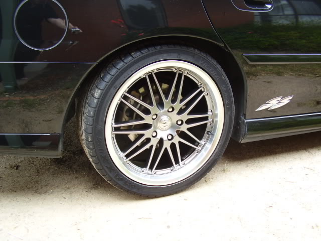

This is what he replaced them with:

#16 _Herne_
_Herne_
Posted 18 January 2008 - 05:50 PM
I thought about your amazing skills but the painted centres are flaking, probably need bead blasting? The one pictured is one of the better ones lol.
