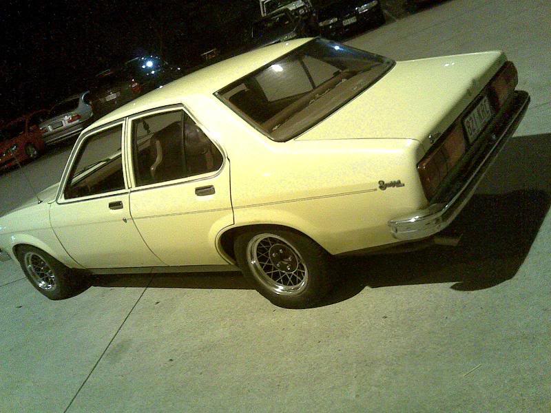

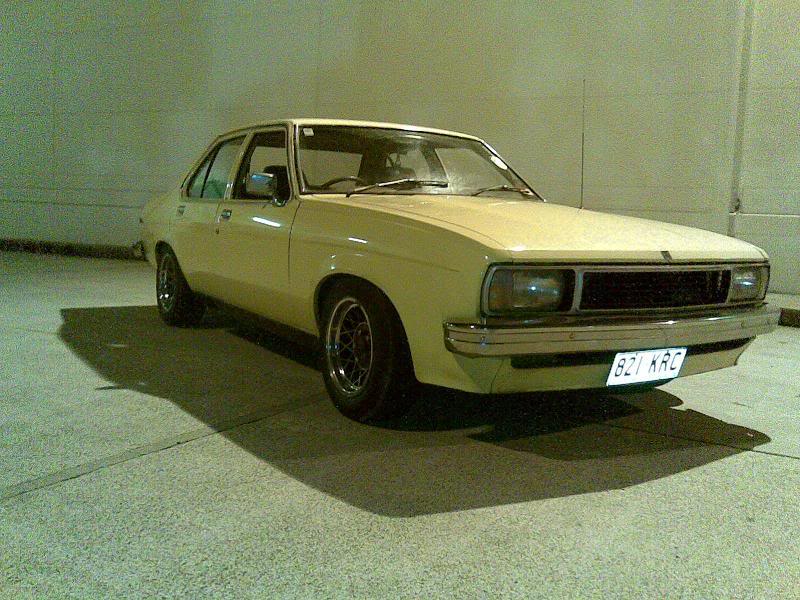

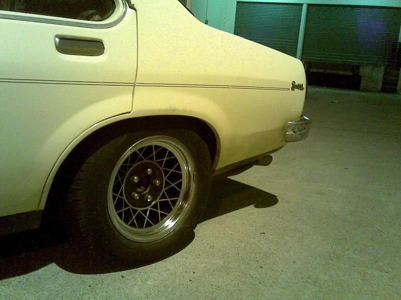

#11 _UCV80_
_UCV80_
Posted 07 February 2008 - 09:49 PM
Pics with camera phone

Posted 07 February 2008 - 10:47 PM
Looks like they came up awesome! The thinners method you used is definitely the best way to go. I've done several sets of hotwires that way, and it gives a perfect result every time, without too much mucking around.
