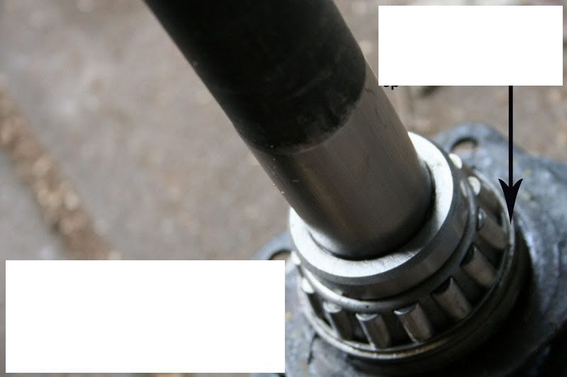

I bought my diff 2nd hand, So im not sure what they used. I am guessing its either a F100 9" shortened for a falcon one shortened. But i got no idea what bearings they use? Or do they use Holden Bearings seeing i'm running holden brakes?
Ignore they white on the picture, its just one that i have in my photobucket that shows the bearing and i edited...
thats the shaft

I can't help with part nos etc but would advise to buy roller bearings to upgrade from the taper ones in the picture above.

I can't tell from that pic but they look like the standard type, mine are a one piece bearing, there is no cone inserted into the housing end.
#10 MRLXSS
  • 12,419 posts
Posted 03 April 2008 - 03:01 PM
So its a case of knocking out the cone that sits in the housing, then just running the one piece bearing like yours pictured? If so that makes sense. No chance of shit getting in there and buggering up your bearings...

MRLXSS. By the looks of your axles, I'd say they are Holden bearings you have there presently and that the axle tubes on the 9" have been modified to accept those bearings and allow you to run standard Holden rear drum brake setup.

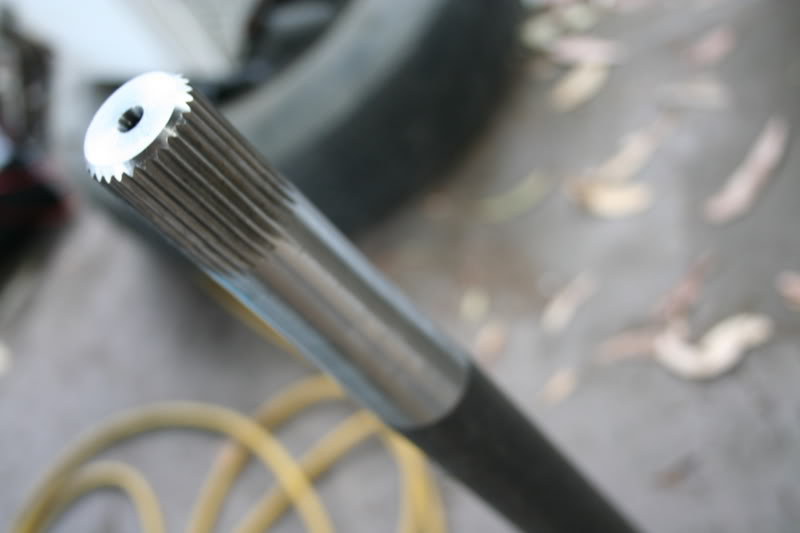

There is another shot of the axles i have...
While i'm sitting here at work, the more i think of it. They do seem to be the same size as the holden ones... definitely look the same anyway...

Axle bearing retaining plates a definitely Holden. I'm quietly confident that the bearings are Holden too.

tapered are allot better as they can handle sideways force, sealed one piece bearings are not designed for sideways force at all, and would be quite dangerous in a diff i would think. Any experts care to enlighten us any more?

HI, They look like HQ bearings and retainer plates. A common 9 inch conversion
for a torana was a HQ tub with bearing housing welded to ford 9 inch housing.
Stick with tapered bearing, handles cornering loads better .

HQ and Torana (1974 onwards) drum brake rear ends use the same bearing.

when you take axles down to diff shop to get the collars pressed off, they will tell you what bearing they are anyhow. You just cant bash them off as some one suggested because you will damage the axle bearing seat.
