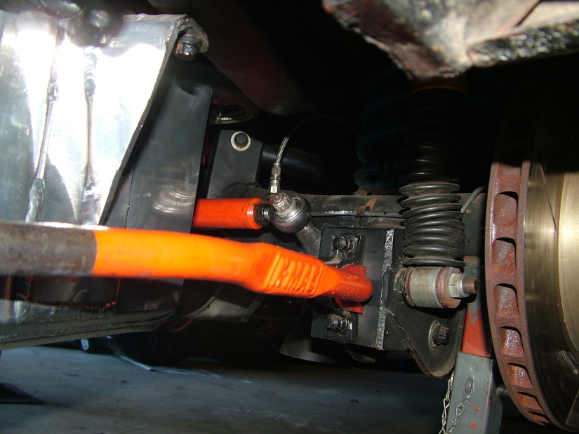

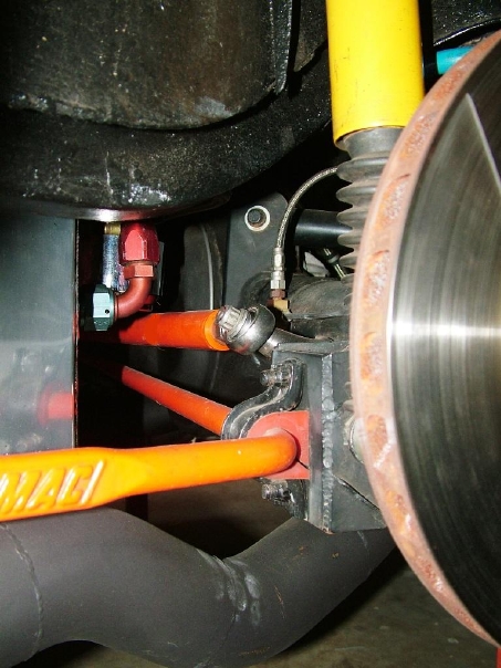

Going by the pictures below it would appear that the standard K-MAC swaybar brackets bolt to the the lower trailing arm bracket and possibly onto the shock pin.
Can you confirm this is the standard setup?
Bomber's Pictures
Litre8
Thanks for the tip Rory.
Edited by ls2lxhatch, 29 April 2008 - 09:45 PM.

Yes Andy.
Couple of different versions there, but same mounting point.
I would not have thought the rear mount would be of much help to you. Certainly with the drop tank anyway.
There is no room back there at the best of times. Is your hatch still in the same place ?
Welby
