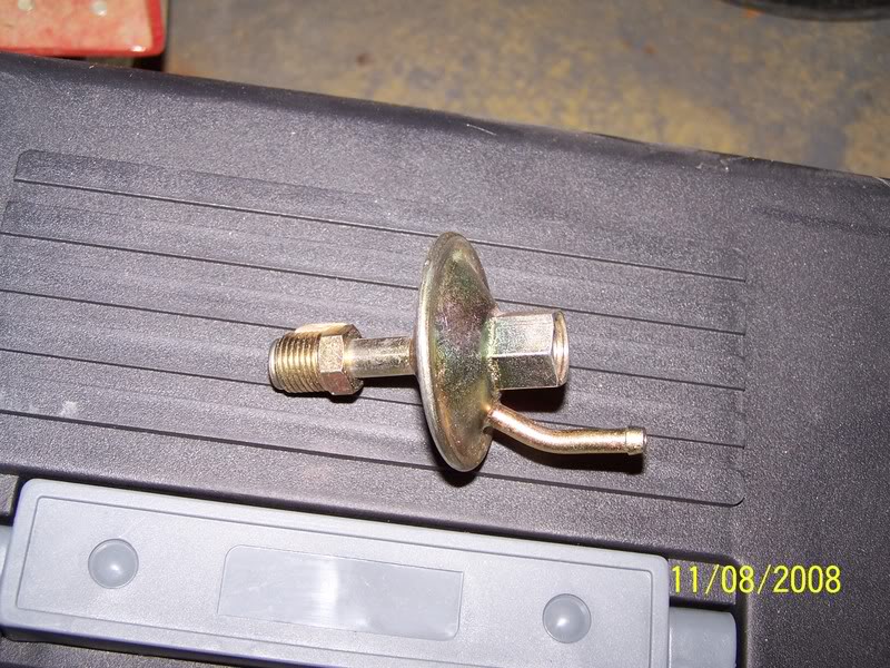

from memory,308s a few years back(maybe early comms) had a small filter on the front of the carb,it was about the size of a fiddy cent coin and gold. Off this, was a small (3-4 mm) pipe which i think returned to the fuel tank.This was to allow a small amount of fuel/vapour back to the tank.I think this would do the job.You could also tee it into the "in" hose on the fuel pump.mervex

Holden are simply refering to the fact that all they sell is the sealed version of the L34 pump now. Originally yes there were 2 different pumps. MRLXSS, MERVEX covered what you are talking about, the filters had a small return line on some models to do what you were talking about. Somewhere I'd have a picture of one.
HJ L31 Statesman was one i know of.
RYCO plastic replacement filter for this was the old valiant one (dont ask for part no) which has this third, smaller return line in built.

#21 REDA9X
REDA9X
    Removed
  • Inactive
  • Pip
  • 0 posts
Posted 11 August 2008 - 04:39 PM
Here is the filter I was trying to find, it has a small return line. This filter screws into the front of the carby
