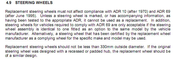

This is an extract from page 20 of the NCOP11 Section LS Suspension and steering document. Posted Image
A complying boss kit must also be fitted.
I do not know if SA have adopted the NCOP.
Autotechnica are listed on the QLD transport website as complying with ADR 10. I would expect that SA have a similar list.
QLD Transport
