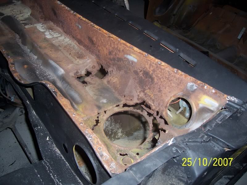

SIR383, if you have any luck with this and get some pics or links could you post them as i have to replace some rust around the airbox on the passenger side (pic 8 in your photo).

#5 _Leakey_
_Leakey_
Posted 11 August 2008 - 09:14 AM
I dint think Graham would mind. Found a pic.

The pics above are of No.8 not No.7 are they not?
How much of No.7 is rusted out? Any pics you can put up?
No.7 just has rust pitting around the lower window channel, when I hit it with the wire wheel some holes came through.
I spent the whole day mig welding up the holes, I luckly won't need to replace it now but what a waste of a day off :)
I dont thik that it would have been that hard to get off just time consuming.
