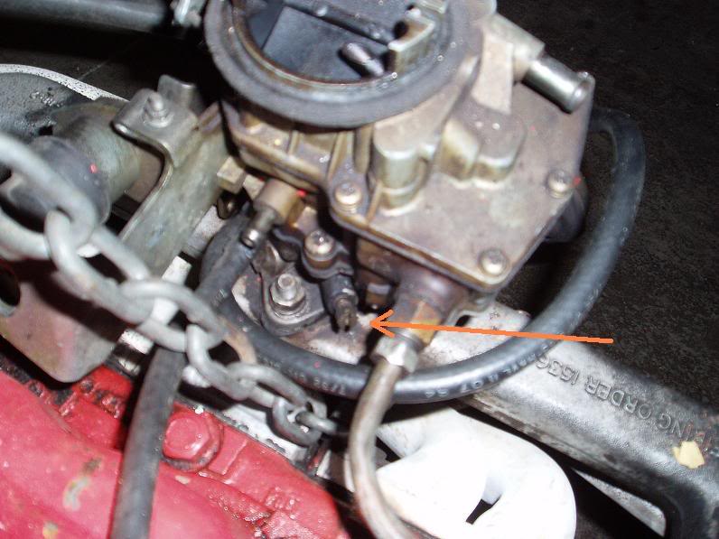

Step 0:
Is this your carby? :huh:

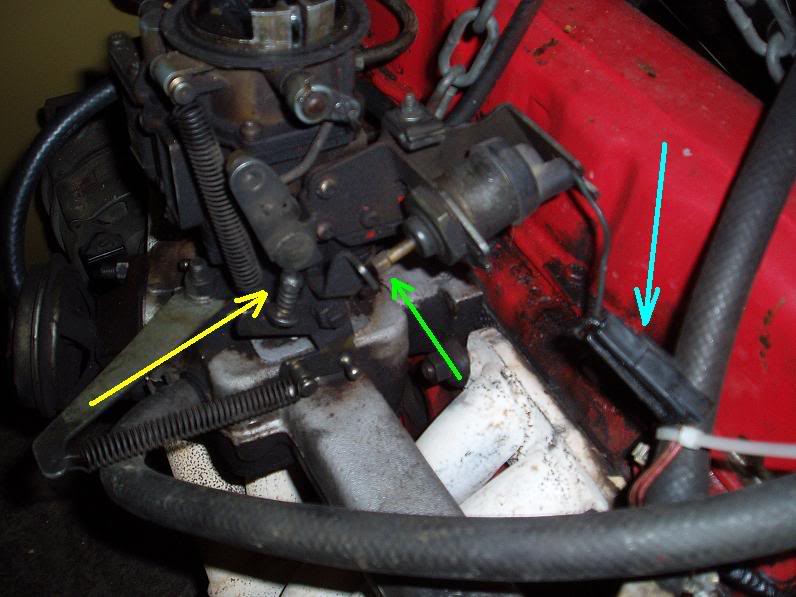

Step 1:
Warm up engine.
Step 2:
Stop engine, disconnect wire at blue arrow.
Step 3:
Start engine and adjust base idle at yellow arrow to 450 - 500rpm. (Use a tacho)
Step 4:
Adjust idle mixture (orange arrow, your screw might be recessed?) to achieve maximum idle rpm. Turn this screw 1/4 of a turn at a time and wait for engine to stabilize.
Once you have achieved the maximum idle rpm, turn the screw in until the tacho drops 50rpm, this will put the adjustment "in the ball park" for emissions.
Step 5:
Re-adjust the base idle at the yellow arrow to 450 - 500rpm.
Step 6:
Stop the engine, re-connect the wire at blue arrow, restart the engine and give the accelerator a little kick.
Adjust the little bolt in the end of the solenoid (green arrow) to achieve an idle speed of around 650rpm. (Maybe a bit higher if auto, put it in drive and see what it idles like?)
This is the way I do it, works for me, may not be right in others brayns, no co-respondance will be entered into. :tease:
