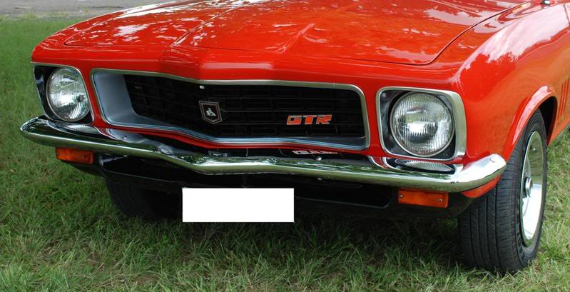

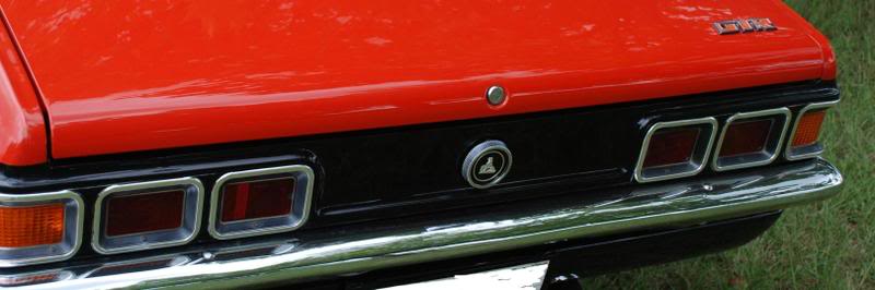

Posted 21 August 2008 - 02:53 PM

I'll put $ on the grile badge being original on an LJ.
Yep, P/N 2819245 with 2 brackets P/N 2819277. It is a special badge because 2810503 (all other GTR badges LC and LJ) do not have the pin length to fit the LJ grille.
