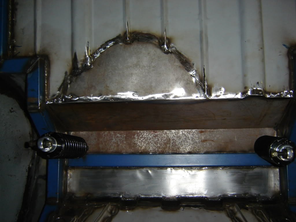

the other section is on a panel i fabricated to cover the coil overs in the boot. i will try to take a pic of that too but it may be difficult.

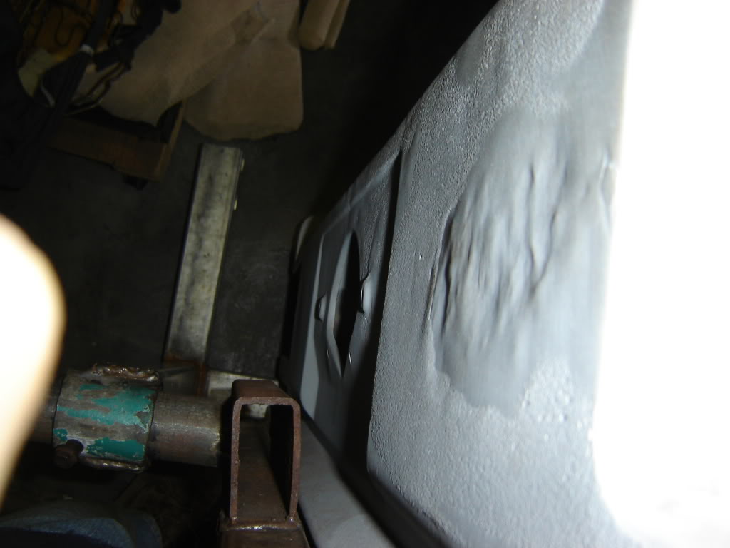

this is the stretched section where the SLR badge used to go

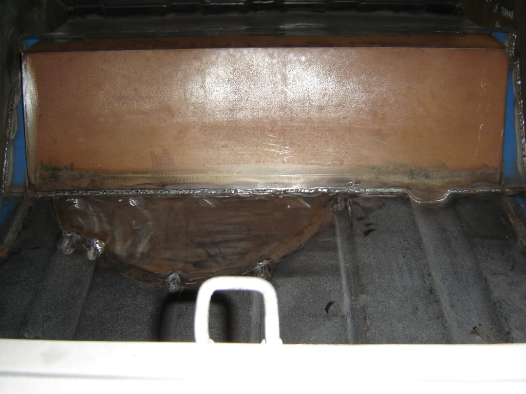

THis is pic 1 of the panel that needs to be shrunk, the big rusty panel. dont worry the rust has been treated and will be blasted
the same but from underneath

That rear panel will be very difficult for you to fix if you haven't done a lot of this before. Lots of high/lows over a reasonable area, and it comes right up to the taillight fold.
Section it out and replace.

the trouble with that rear panel is it is curved both ways,across the car and vertically,so it will not be straight anyway and will appear to have a wobble in it.i would leave that to the beater,or replace the whole thing.depending on how the channel is and under the channel for the rubber.if it is all rusty,then i would look at replacing the whole rear panel,with an moletsed one.with it being one of the first places people see when following you,you want it straght,and know amount of shrinking and hammering will get that to a bogless repair.

I think this is still very repairable, you will definately need a lot more hammer work before trying to do any shrinking, if you did try and shrink it now I think you would make it worse.
I'd start by making sure you have complete access to the back of this panel, I know some LH/LX's have pretty good access to this part but some others only have round holes. If you need to gain access I would be cutting out the inner so you can get a dolly on the back of this and then rewelding it back into place later.
I'm guessing there once were badge holes there that have been welded up? this will have caused some of the problem to start with if they haven't been hammered up properly.
To repair it, I would start by bumping it into the outer position like it is in the photo, and then hammer up the lows that are surrounding the high spot (you can see in the pic to the upper right corner and surrounding the high spot) to try and unlock the springiness of the panel, then I would be trying to planish out the wrinkles and knock down the highs and bring up the lows so you have a consistent surface (don't be too concerned if it still is consistenly high ie. it looks pregnant)
Once you have a consistent surface and the oil can has been unlocked then I would start shrinking, if you use a heat shrink with an oxy torch I would start with small shrinks so it doesnt get away on ya. You need to get the steel cherry red about the size of a 5-10cent piece as quickly as possible then using a dolly thats crown is slightly lower than your panels current crown you then hammer lightly around the edge of the heated area in a circular pattern then quench with a wet rag or compressed air or let it air cool. Which ever way you decide to cool it is up to you as it will end up the same no matter what, a wet rag is the fastest method.
Alternatively you can buy a shrinking disc, they're a little hard to get a hold of at the moment but from what I've seen they're cheap compared to an oxy set-up. They work by creating heat using friction and then you cool it using a wet rag etc. It definately seems a lot more controlled way to bring an entire panel down than using a heap of heat shrinks. I'm waiting for the bloke I know of that sells them to get them back in stock so I can buy one and give it a crack myself.
Good luck with it, from all the work you've done so far I would hazard a guess and say it's not beyond ya thats for sure.
