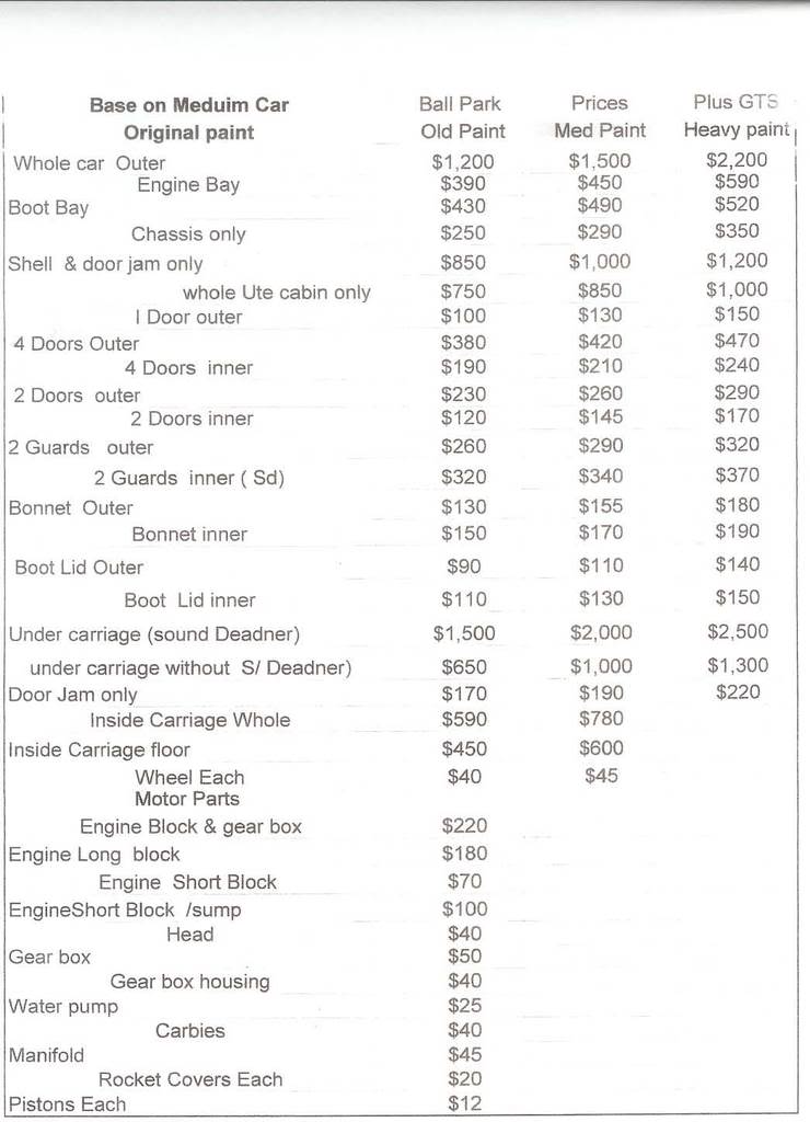

Do you know how much they charge to do a car Kev?

I had mine sand blasted and am happy with the job cost $1400 for everything even underneath and enginebay. sand blasting does not remove all of the old bog and a good one will not do centre of bonnet, boot, roof too much because of possible warpage so you may have to do a bit there yourself.
probably not good on a car unless its is completely stripped bare.
the only thing is that after many times turning on the rotisary i still get old garnet on the garage floor. although i must say not very much at all any more.
