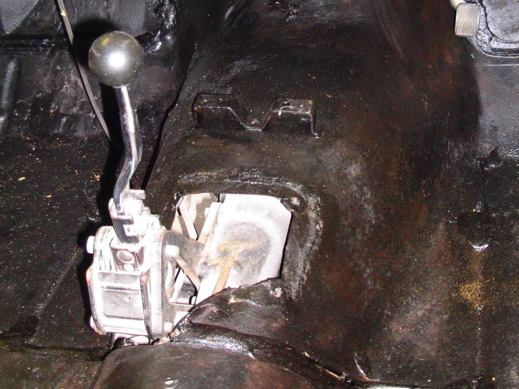

#6 _OrangeSS_
_OrangeSS_
Posted 21 February 2009 - 10:34 AM
This is where it's at at the moment...

#8 unclefestal34s
unclefestal34s
  • 1,130 posts
  • Joined: 02-April 07
Posted 24 February 2009 - 02:08 PM
judging by your photo,you need to move the bracket that shifter bolts to forward,there are extra holes on this bracket and your gearbox has extra holes as well,this nearly centres it from the original hole but still on the left hand side..this means cutting it as well you will gain a fair bit forward then make a bracket of your gear stick according to suit your console..i hope this helps as i've done this a few times before..

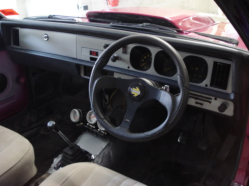

My cousin went through this with the SS I sold for him recently, If you're open to changing the shifter, you can do as he did and purchase a reco genuine shifter from Bob Matic (Ford Muscle Parts) that is modified to suit a Torana and it sit's fairly nicely. If I can recall it was just a bolt in.
When he purchased the car it had a Renegate which was all the way over on the passenger's side, all the B & M's he purchased had the same problem without requiring major modifications, so he went the genuine route...
Don't mind the mess, it was a work in progress...
