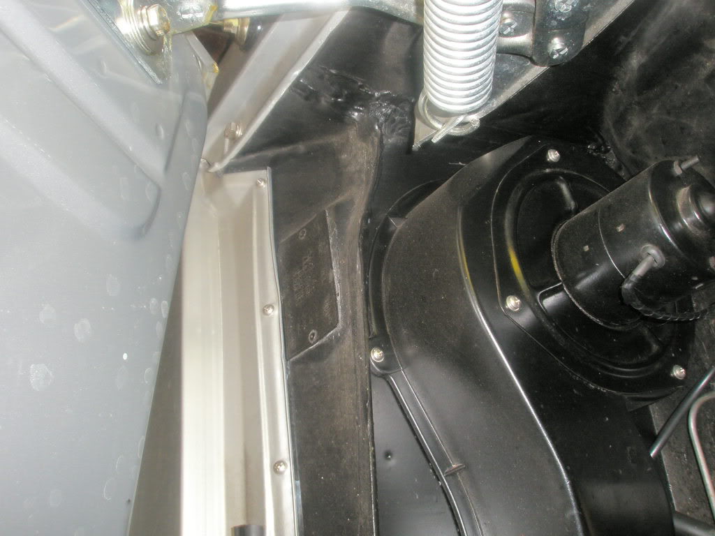

The Chassis number should be here:
It's the small rectangular bit that you can just make out on top of the chassis rail (beside the radiator and under the intake pipe, right in the middle of the photo).
And yes, they are quite often painted over. A little bit of sanding will normally uncover it.

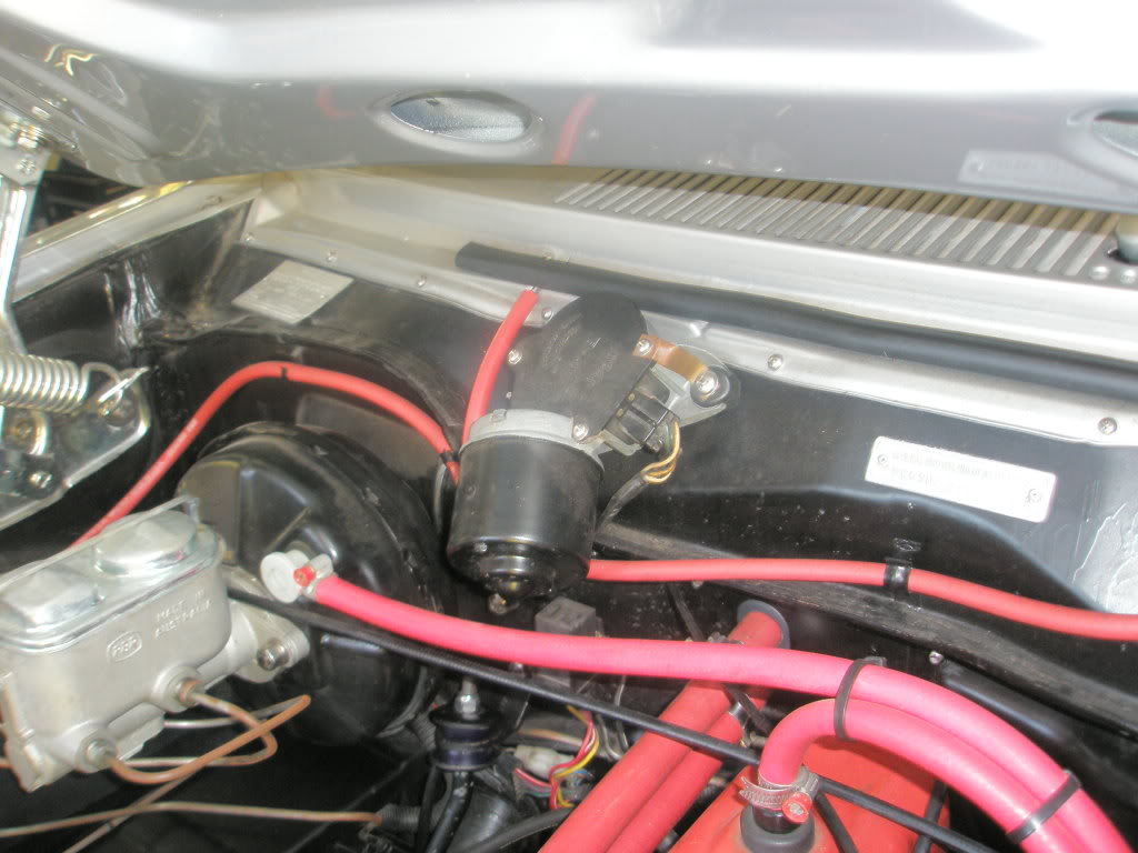

There are also 3 plates along the upper rear edge of the engine bay:
2 shiny ones (drivers side and middle)
and 1 painted one on the passenger side (I think they're normally painted, dunno why).
I hope this helps.

Yeh, My partner had a look at the car last night. Was too dark to see much he reckoned, and said he couldnt see anything. But he didnt know exactly where to look either.
From my memory - The chassis number would be sitting right under the charcol cannister, no wonder I cant find it on my sedan!!!!!
Anyway, we bought the hatch anyway. Pick it up this weekend. Hopefully the number is there, if not bad luck. As I think it was an SS :(:(
Thanks so much for the pics, really nails it on the head.
