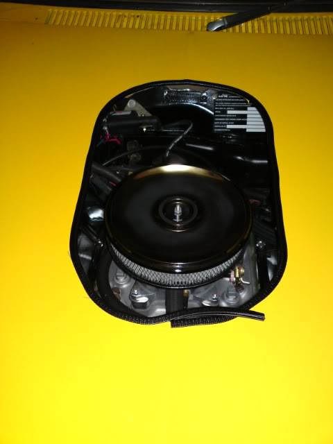

The Sunroof Centre have an electric shear, looks like a nibbler. It cut this hole with ease:
#18 _@milco@_
_@milco@_
Posted 25 June 2009 - 10:30 AM
how did they get the edges all nice like that?
#19 V-SLR5000-P
V-SLR5000-P
  • 1,321 posts
  • Location:Victoria
  • Car:L34 x 2
  • Joined: 14-November 06
Posted 25 June 2009 - 08:07 PM
I didn't want a rubber trim around the hole. A mate who is a talented panel beater folded the edge by hand with vice grips (all very high tech!). Once it was over around 45 degrees he finished it off with a hammer and dolly. The edge put alot of strength back into the panel and stopped it flexing.
