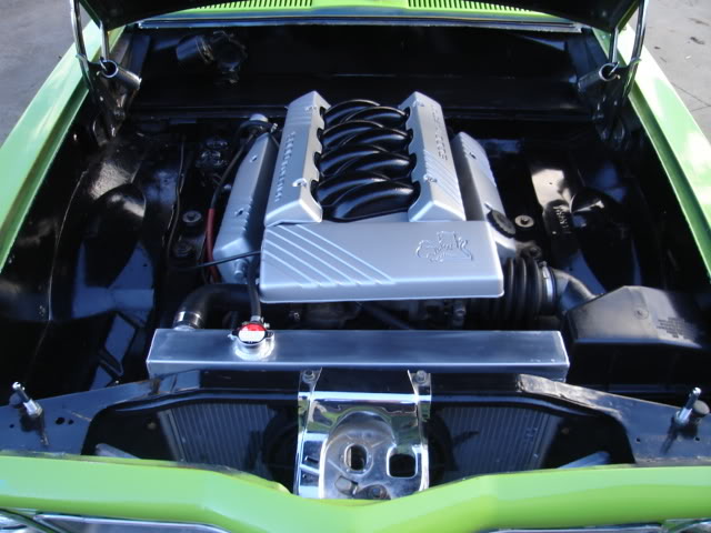

#7 _XU1-043_
_XU1-043_
Posted 23 July 2009 - 05:22 PM
yep all pod filters are noisey on descent size motors, i had one on my old V6 commodore wich was pretty loud so when it came to putting one in my torana (injected 5L) i used the standard airbox cut the base out so it would fit low enough to fit in the engine bay and used a K&N panel filter.
