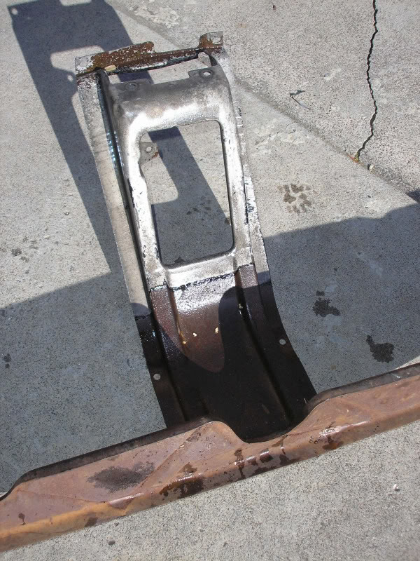

This is a 56 Chevy hood support that l had partially submerged in a molasses bath for the last week. The surface rust has almost completely gone after just a quick rinse off. l had a similar result with a rusty sump pan which came up clean after two weeks. The solution used is 1 part molasses to 5 parts water mixed in a large plastic tub. Looks and smells awful, but rips the rust off a treat.

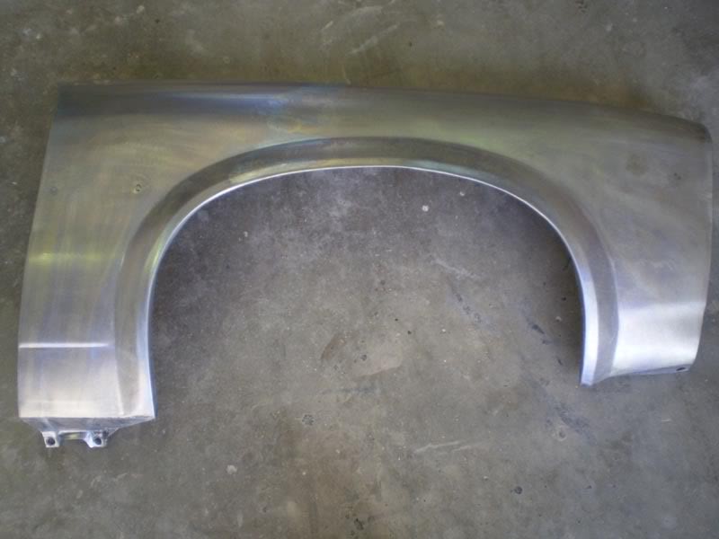

POR15 Metal Ready is a Phosphoric acid based rust dissolver and etch. POR15 Metal Ready is one of many products made by the company POR15 which is best known for its rust preventative paint. It is similar to K&H Rust Dissolver and Ranex which are also Phosphoric acid based.
This is a panel that has been treated with POR15 Metal Ready.
