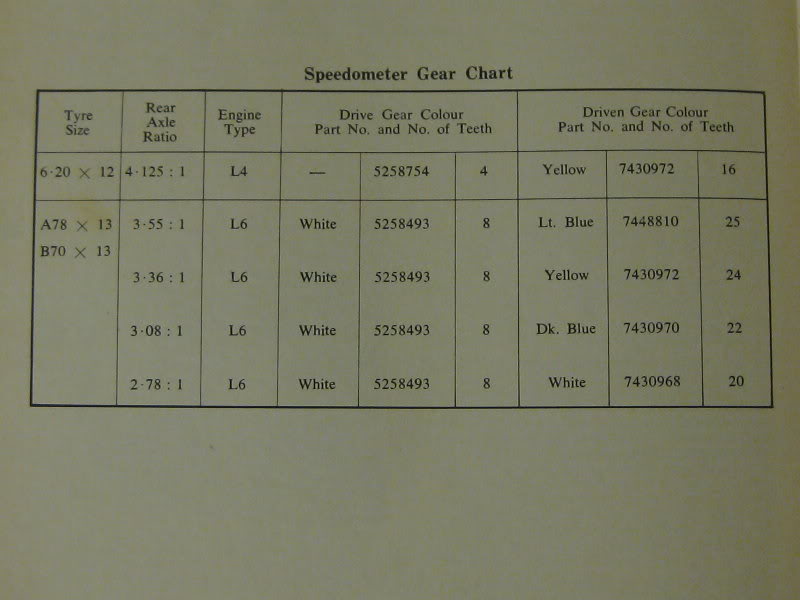

I have a LC 6cl, auto trimatic tranny and 13 inch 205/60/ on the rear. I have changed my diff center to a 336 ratio (from 278) and would like to know what type/color speedo gear I would require for my speedo to work correctly.

Calculations in this thread:

Thanks for the info. I am sort of working it out. Do you know how many teeth are on the Speed Gear Drive for a 6cyl trimatic.

This is taken from the Trimatic Section of the LC Workshop Manual

Yellow it is. Thanks for all your info and time taken to help.
