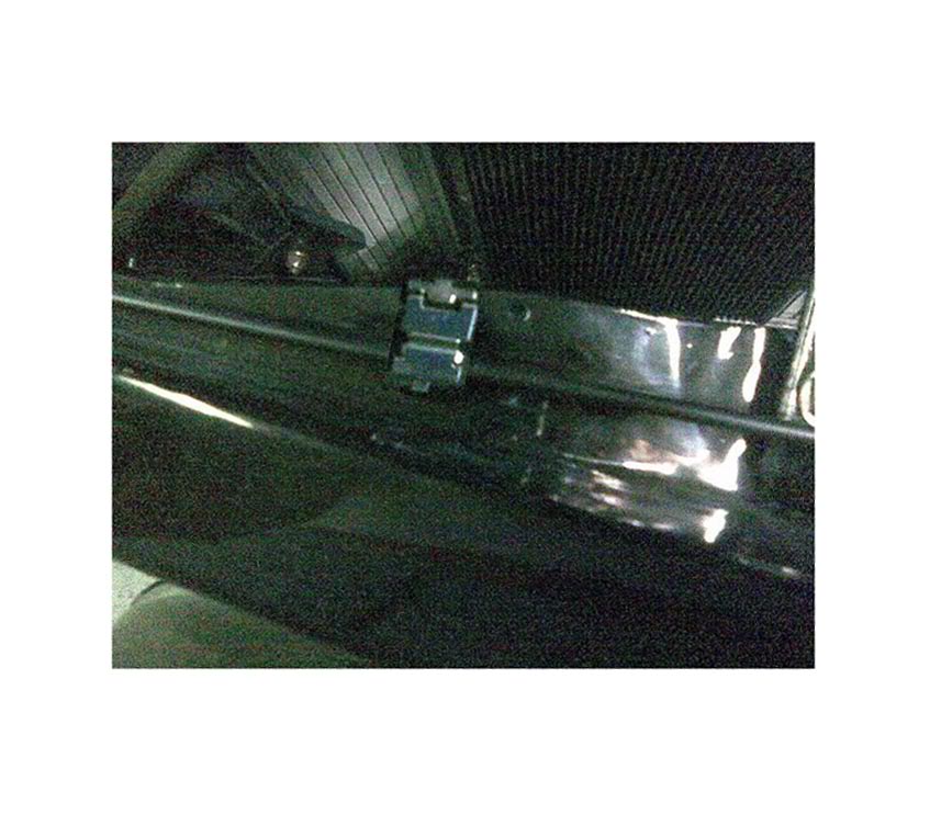

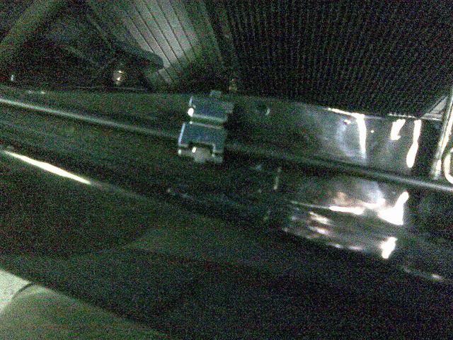

Posted 02 April 2010 - 05:20 PM
I can see how it has to sit in the end but Cant seem to get it there :(

#6 _Bomber Watson_
Posted 02 April 2010 - 07:02 PM
frOck the chrome shit off and do what Heath said.
Or take a better pick cause i cant tell a damb thing from it, can only guess by the posts.

#9 ls2lxhatch
  • 5,335 posts
Posted 02 April 2010 - 08:48 PM
I think Josh is right you have the clip upside down. I have photoshopped it rotated 180 degrees.
Edited by ls2lxhatch, 02 April 2010 - 08:53 PM.
#10 _Viper_
_Viper_
Posted 02 April 2010 - 09:43 PM
cant possibly go that way, the end is long and thin (and fits into the small round hole) other end is wide and wouldnt fit into that small round hole.. If I had a decent camera I could show ya
#11 ls2lxhatch
  • 5,335 posts
Posted 02 April 2010 - 10:22 PM
I had a look at the parts manual and can see that you had it the right way up.
