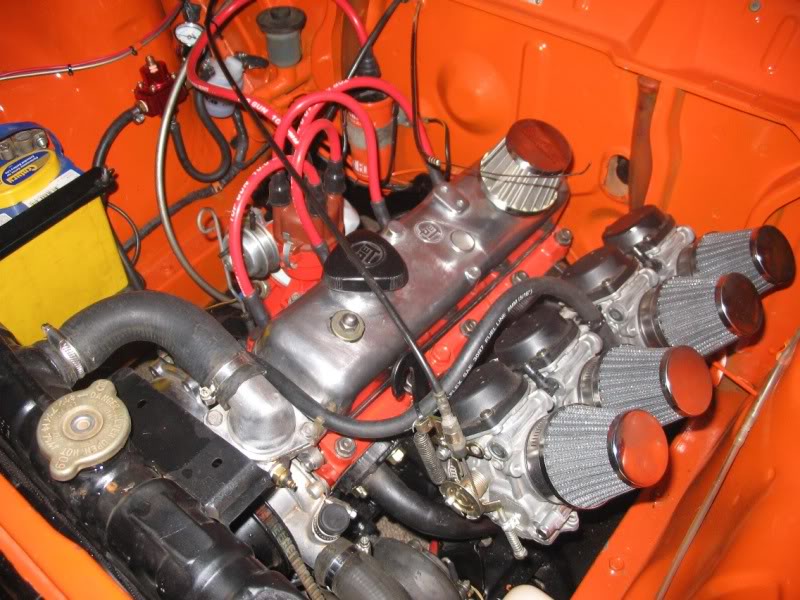

Posted 01 June 2012 - 12:47 PM
I don't know if anyone has seen this before? Posted Image It's from the V Power site mentioned above, but I haven't been able to find any further info.
http://www.v-performance.com/content_files/j&s%201%20002.JPG

Below is a email I got from John at Vintage Performance about the installation shown.
" I have changed the throttle adjustment ( he means the idle adjust ) to the short ones and I would recomend that on any others you do for the Holden straight 6 as the long ones get to near the exhaust. I also changed the pilot to a 30 (25 originally in there= idles really well and at 600= noramlly would be 750 to 800 rpm) then took it for a run. Tis a revalation in throttle response- both quick and light. The performance is very good and that is without getting on the dyno. I have a very small flat spot around 3000rpm and a little flat in accelaration from 3500 to 4500, but will wait until I get on the dyno before I change anything else.
Needless to say I have a smile from ear to ear,,,,,
Thanks for your patience and advise. Will keep you informed. Stacey "
"Stacey who did the installation on a Holden 6 ended up his tuning efforts with -pilot:25 ; needle jet :Y8 jet needle : 96-cir-clip at bottom setting (richest) : Main jet 180. Not sure exactly how his engine compares to yours but you can email him to find out."
I am just completing my 202 with the 42 HSRs and at this stage it looks like it will be started Wednesday. I will let you know how it goes although I will have nothing to compare it to.
#12 _triumph202_
_triumph202_
Posted 02 June 2012 - 11:35 AM
Thanks for posting that Peter.
I'm seriously considering buying two HSR 42's to go onto the Cain twin SU manifold I just purchased. I've already got two SU's, but one need to be rebuilt (and I don't know if I want to invest more $$$ into the SU's?)
