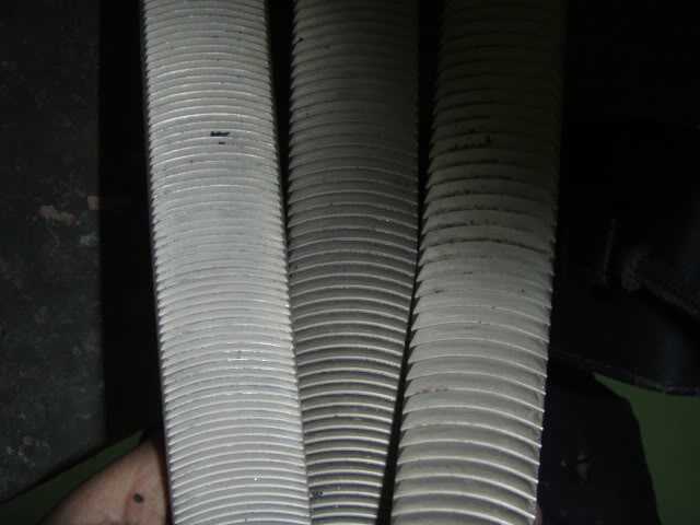

if you are metal finishing you want the finest blade as they to groove out the metal and they guide along the panel the way they are supposed to when metal filing. the courser blades are for bog. then they have the even courser blade and that is for plastics i will post some pics of what sizes they are for you to see.

here is a picture of all types of blades left to right is, metal file, bog file, plastic file

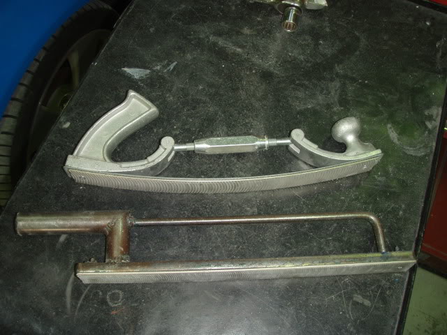

this pic is my home made metal file base and the peice of crap adjustable one that they sell lol

Why is the adjustable one a peice of crap? Ive got one, Ive barely used it... but yea just wondering (honest question)
#14 _yldlj_
_yldlj_
Posted 17 July 2010 - 06:54 PM
they never stay straight!!!!!!! there good for curved panels only i hardly ever use it and i metal finish every day
