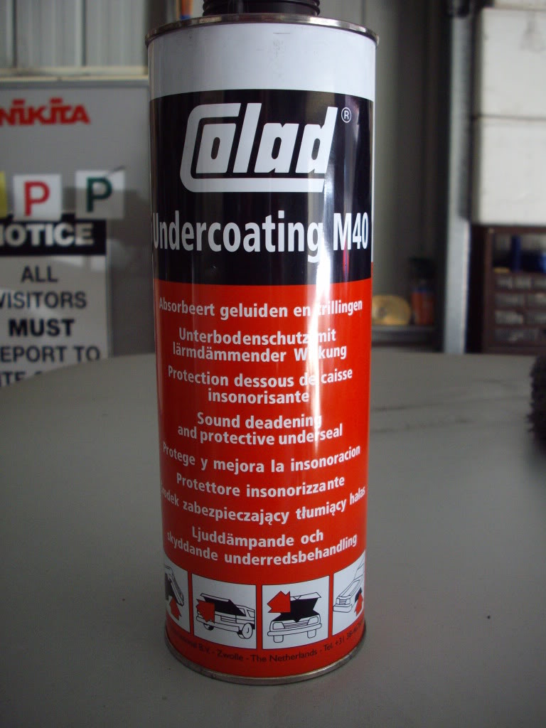

Posted Image LMFAO sry there Lee my keyboard wouldnt stay still Posted Image it was suposed to say " i use 2k Etch primmer then Shiltz wich is the tar based sh*t " ....... i have always known it a body shiltz here are some pic's of the product.

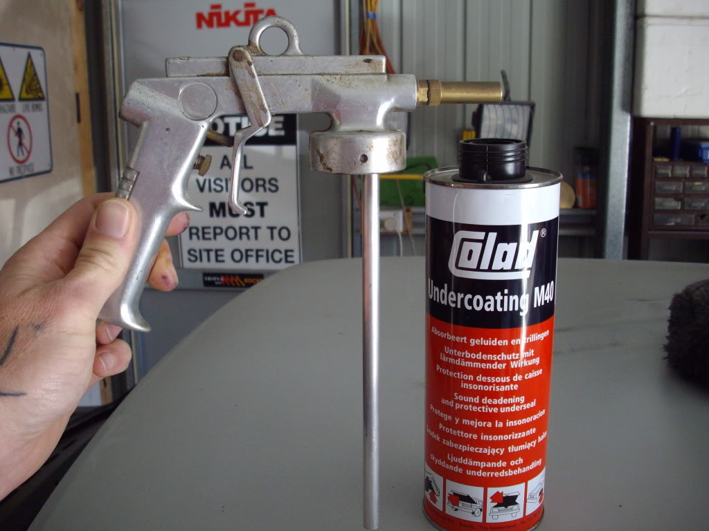

the tube of shiltz screws straight on to this gun wich is just my fish oil gun, the tip can be changed and i have a clear tube/hose with a fitting on the end of it for getting into tight spots when fish oiling, here is a pic of the gun i use.
