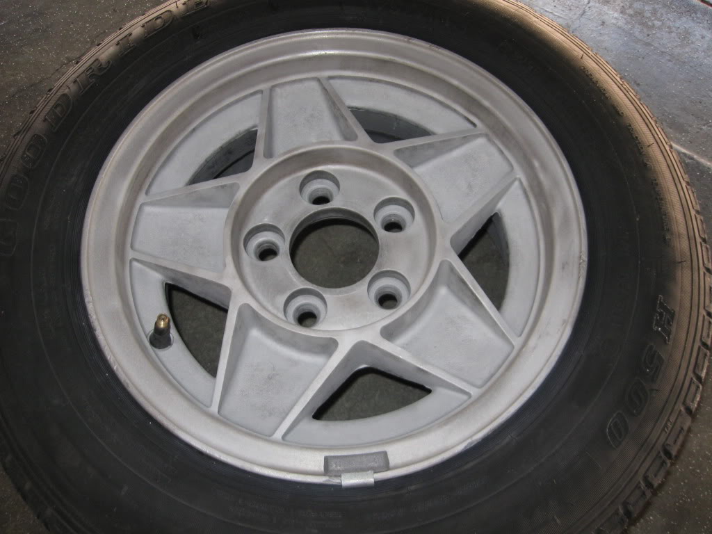

Hey guys,
Just wondering if you could help us out at all.
Picked up a set of CSA Globe mags the other week, but like all wheels for sale they didnt have any wheel nuts included
Anyway was just wondering if anyone knows of a unique nut that suits, as the hole size is smaller and has a tapered seat unlike a normal flat seat type
Briana
Pic for reference if it helps :)

You need some 7/16" UNF taper wheel nuts. Probably to suit a 19mm socket, but if the clearance is tight, you can get wheel nuts that use allen key heads. Just don't use rattle guns if you go for the allen key nuts, as I've seen them split.

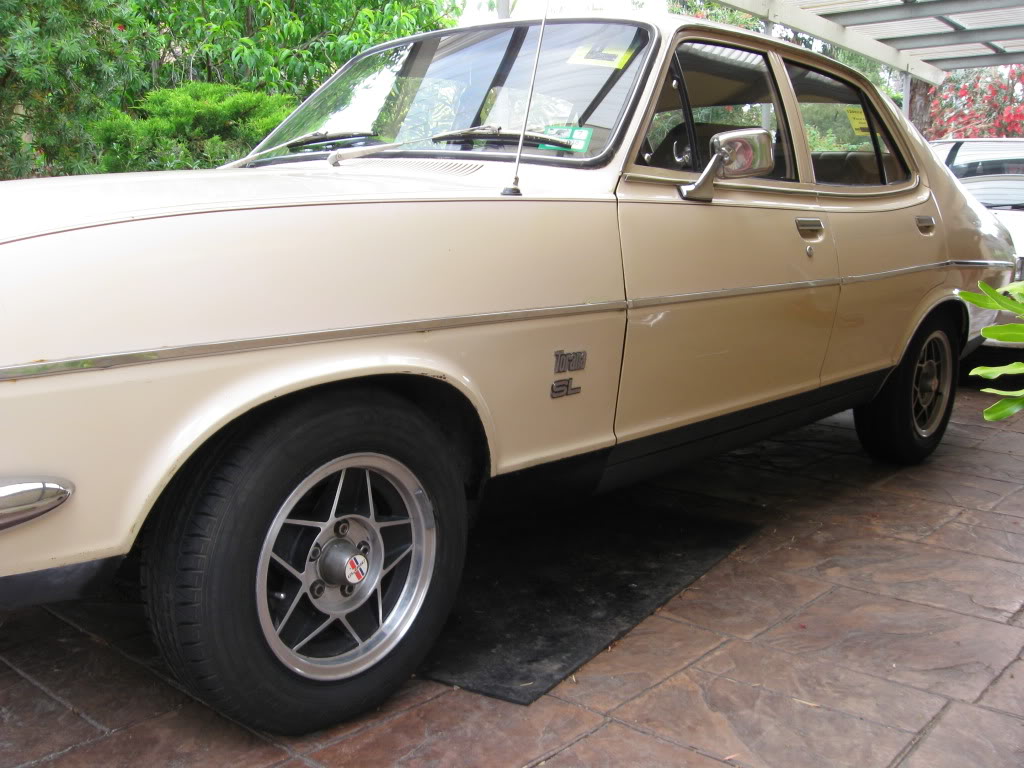

Heres what they looked like on anyway

Just was unsure as to whether you could run a standard wheel nut on straight alloy as there isn't any steel insert.
Do you reckon the stockie wheel nuts will be fine then???
The only problem is making sure the socket or wheel brace gets around the nut without damaging the wheel, sometimes a slightly smaller outside nut size can be useful but any tapered nut that goes on properly will do

Thanks for the responses
I would use new nuts due to the fact there is no steel insert in the rims. Otherwise stock wheel nuts that are a bit chewed out in the taper can dig into the seat of the rims, buggering the taper in the rims. This isn't ideal, as buggered tapers can lead to nuts coming loose.
Is it just me or do those nuts look like they are not seated far enough onto the studs?
This was just used as a trial fit to see what they would look like...cant remember if they bottomed out or not..dont think ill use those nuts now anyway, might head for what chopper said and buy some new tapered nuts, if thats all i can use on them
