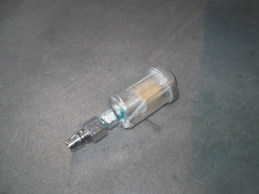

Thanks for the replies. When you mentioned oil getting past the rings I was like 'what the hell?', as far as I knew this thing didn't have an internal combustion motor. I'd never put fuel in it! So I found a diagram of all the parts and pulled the cover off the actual compressor to sort of examine whats what when it suddenly made sense. So basically an electric motor drives a crankshaft which draws air in via a one way valve and piston/rings/bore and compresses it back out and down a tube which feeds into the tank.
Well I'm assuming the rings are possibly a bit worn as it has used about 30ml of oil since i last checked which was probably about 6 months ago. I checked out some Deltech filters on the internet but they are really too expensive. There are some other brands of inline filters on ebay which claim to seperate oil as well as moisture but I'm not sure if I should trust this. The photo below is of the inline moisture filter I've been using for the past couple of years. It just screws into the bottom of the spraygun. I'm not sure if something like this is capable of filtering out oil as well or whether something completely different is required to reliably do this.
I get the idea that in an ideal situation you would run a good compressor that doesn't let any oil past the rings coupled with an expensive oil and moisture trap, but this would mean spending lots of $$$$ that i honestly can't justify spending that much. If anyone can recomend a reliable type of filter that isn't too expensive that would be awesome.
