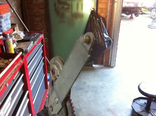

Hey guys, Noticed that one of the rollers on the rear door window mechanism is missing...
Well the plastic bit anyway? is it possible to replace these? or will I need another unit

I think Rareys still sell replacement rollers & pins. Check their website.
I was toying around with the idea of using sealed bearings as a replacement.

rares dont do rollers any more they have sliders i put some in mine they work bloody good just make sure you lube up the channels so they move easy and dont wear

just found part number RK171
they are under door components on hq on the website
