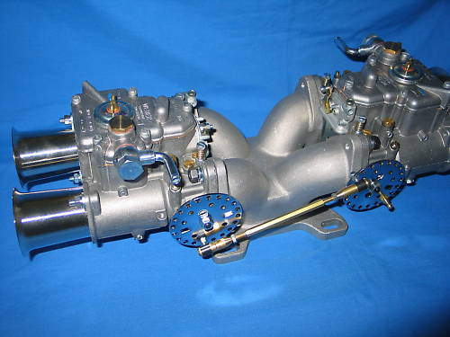

#10 _Mr S_
_Mr S_
Posted 02 July 2013 - 03:48 PM
G'day all,
Was after more info regarding the twin 45 side draft Weber setup on a 308.
Is anyone here running this setup?
Will they out perform lets say a 750 double pumper?
Has anyone managed to keep them under the bonnet? This is the only reason i wont use down drafts
Any help would be great. Cheers
BtlPLqwEGkKGrHqMOKjMEvNg7S9BL8lVRyGw_121

As Ned says, its all about function.
Webers give their absolute best when you can match them one throat per cylinder.  Easy with an inline six, three carbs hanging off the side. Also easy with an 8, if you have the room.
Most of the worlds classic high end cars ran webers.
In the poor old Torrie, we struggle with bonnet room. Lots of L34's ran twin side draught similar to above post 10 ^, then in the A9X they were able to go to post 8 ^ because of the hood scoop.
I have run quads and were very impressed with them. I am currently setting up dual side draughts for my LX 308 sedan.
Good luck.

Here's mine

Welby what manifold you gonna have that bolted to? pic would be nice thanks

2 45 dcoe's sitting on a torque power dual plane manifold.

low rise?
does it fit under the bonnet or you have to cut a hole?

Why aren't there more setups like yours,
