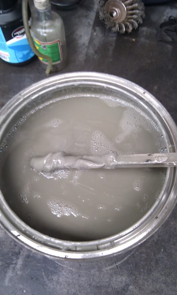

_73LJWhiteSL_
Posted 20 April 2011 - 10:37 AM
Yep, its rooted. Looks like its going in the bin.
Steve
Steve

#7
Posted 20 April 2011 - 09:05 PM
That looks ok???
Stir the crap outa it and see what happens.
#8
_uncleian_
Posted 20 April 2011 - 09:06 PM
use a paint mixer in a drill and it will be good
#9
_73LJWhiteSL_
Posted 20 April 2011 - 11:57 PM
Ok so you guys reckon a bit of stirring and it will be ok? That would be good to hear, because if its ok and the humidity drops a bit i'm gonna have a go getting it on the car.
The Datasheet (link in first post) suggests up to 40% reduction with thinners. So That means I use up to 60% etch and 40% thinners? Or should I just use straight etch? Sorry to sound a bit green, I'm not sure how to mix it, and my last attempt I think I put way too much thinners in.
Thanks
Steve
Thanks
Steve

#10
Posted 21 April 2011 - 05:43 AM
Yep and yep.
If after continued stirring it looks strange still then chuck it. The way it is there is just settled, resin on top and clay to the bottom (primer is basically resin clay and talc).
That should stir up though.
And yeah 40% thinners means 60% paint 40% thinners. You can use less thinners but i like spraying etches real thin.
