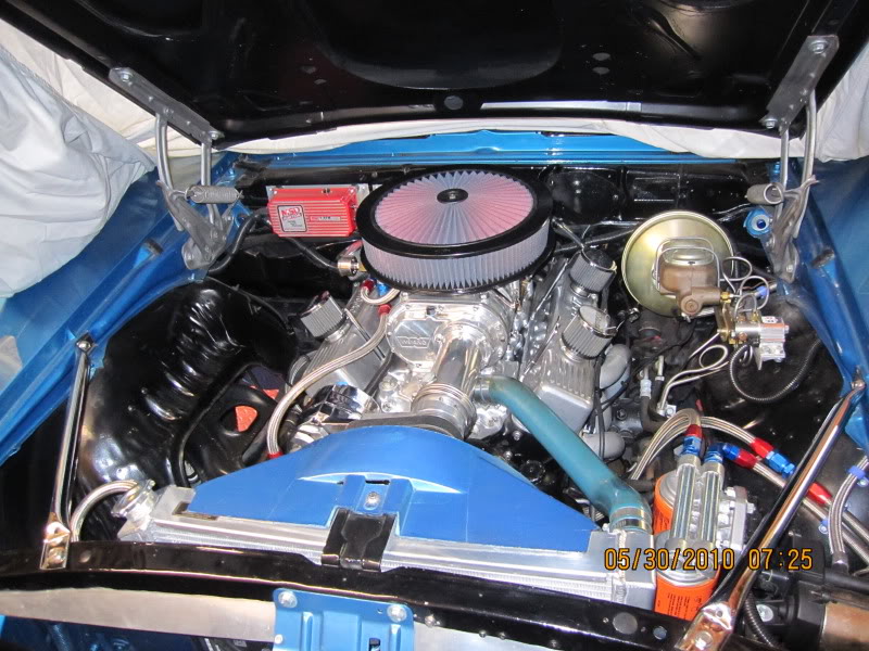

A guy on a Mopar forum I am on (I don't know him, just remembered his post before) has a '69 Camaro with one on it...from the pics I have seen, it fits under a cowl induction hood on it, and he also mentioned...
one more thing...from the bottom of the intake(sbc)to the top of the carb, its 11.5 inches..
So perhaps you can see how much taller that would be than a normal intake/carby setup and see if that would get covered by the scoop ? (I have a pretty tall Edelbrock XT EFI intake on my LS1 and the A9X scoop covers it just fine. )
Here it is on the Camaro...

That's awesome! Great photo - he's obviously running a drop base air cleaner. Thermostat housing looks tight too, but as long as it works, it works! Damn that looks nice :)
I'll have to do some measuring of standard intake and carb for reference. Will be very interesting to see how it compares. Thanks very much for that info Jeff.
PS. I just want to say it again - damn that looks awesome!
