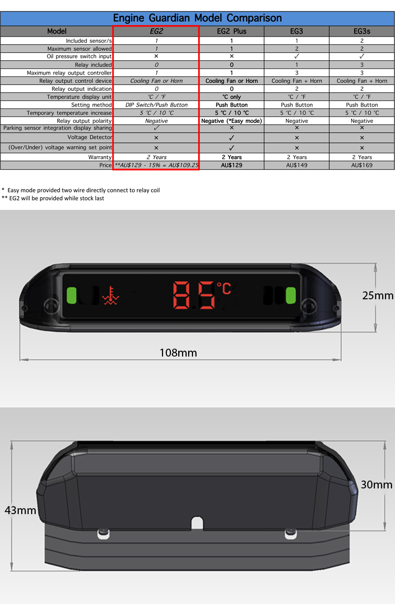

I used one of these. Great product with programmable on/off, over temp warning and easy to fit.
Engine Guardian

Craig , how does the temp sensor go one , just bolted up? Look like a good unit though

#10 _CraigA_
_CraigA_
Posted 01 July 2011 - 05:49 PM
Sounds rough I suppose but I just TEK screwed the sensor to the top of my thermostat housing. Works perfectly and is accurate against the factory XU1 gauge.
I like the fact you can set a warm up temp (the unit beeps), a fan on temp (I use 85 deg C), and fan off temp (I use 76 deg C) and has two visual and audible overheat warnings (I use 95 deg C for the first one, 105 deg C for the second one). All temps are easily programmable.
