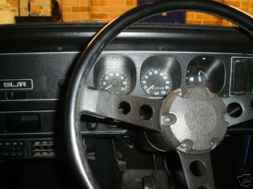

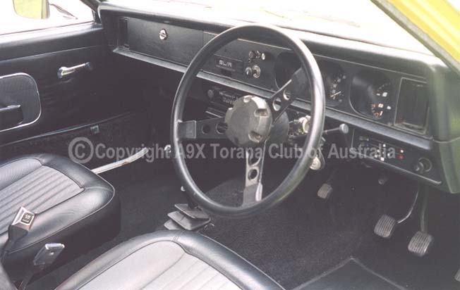

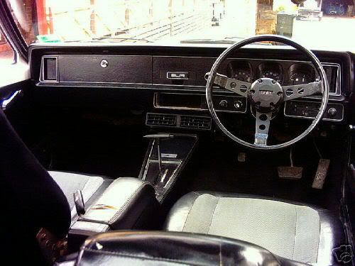

all the ones ive seen havent got it. i have one here that looks as if its never had it.
Hmmm, hope this doesnt confuse the issue.
** apologies to the A9X club. If an issue, I will remove pic.
Most importantly, in addition to the silver on the edging, you will need to really carefully 'inject'
some matte black in to the area around the letters and inside them... yep...its paint in there.
I would suggest using a syringe, a very watered down paint, maybe even a water base, and just let it
get dry over a few days.

Thank you very much for those pictures. I think that pretty much proves the point!!!!

nice pic,s, i was starting to think they didnt have it but they show pretty clearly they do.

the seats in the upper photos are the same as the ones in my car but the door trims are differant. mine are black golfball with the crome going all the way to the frount of the door. were these trims offered with those seats?

LH seats with what appears to be LX door trims
