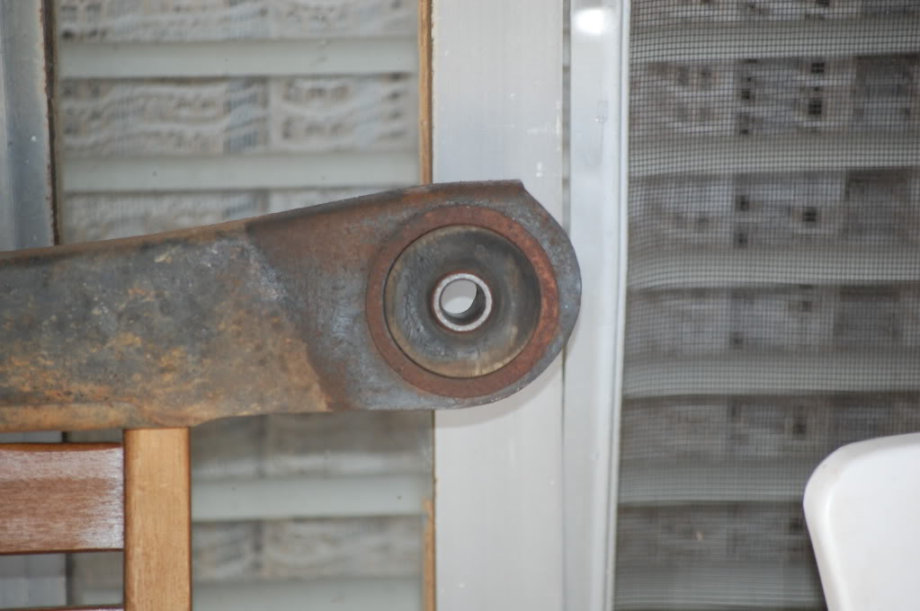

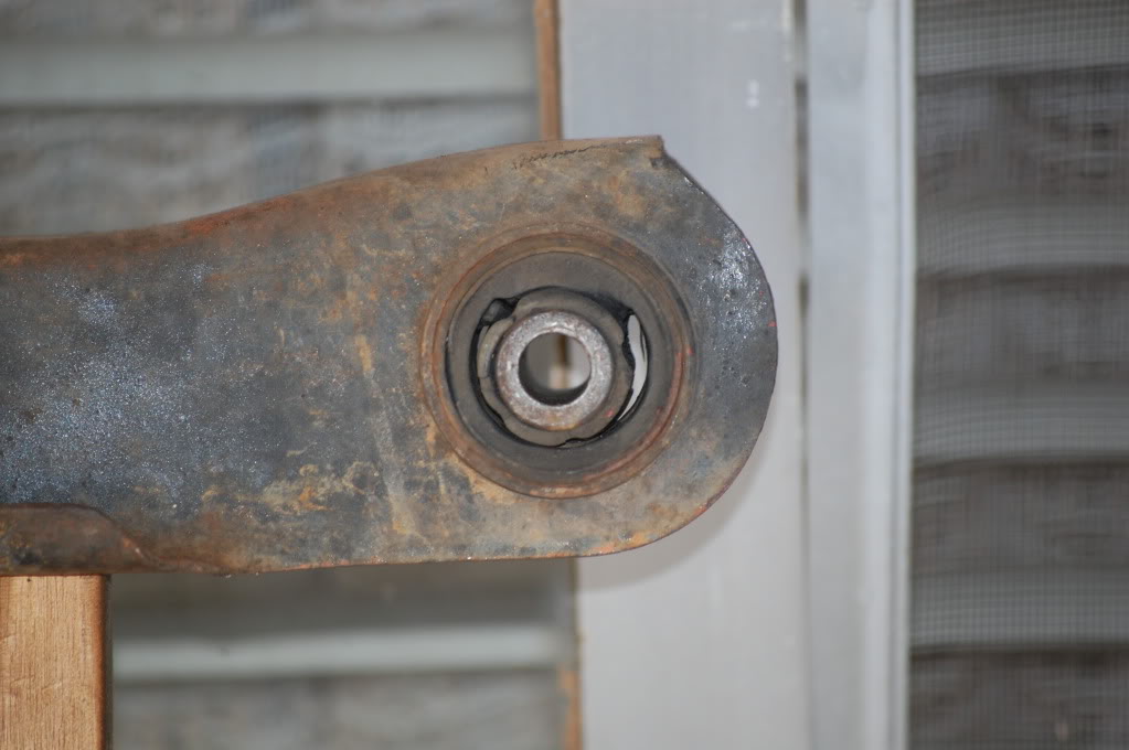

the ones im having trouble with are the ones in the lower trailing arms either side, one end had the original holden bushes which are 47mm diameter and the one at the other end are a different bush all together and they are
44mm diameter the bush kit i bought all fitted everywhere else bar the two in mention hopfully these pics load up and someone could tell me wats going on
cheers for the help
this is the odd one 44mm
this is the original holden one 47mm

And now what does it look like with the bush out ?
#13 _runt1_
_runt1_
Posted 25 September 2011 - 07:00 PM
looks exactly like the other ones when they were out just that the hole is 3mm smaller in diameter and bush aint gona fit

From your pic its the diff end not the body mount end thats the problem yes?
I checked the spares in the shed and as mentioned above the size is the same as the body mount end. The "flange" on the bush looks quite different to your pic (mine are original never changed).
I gather there is no evidence yours have been cut and had different ends welded on?
Please let us know if the suspension experts have an explanation after your visit to get them done.
