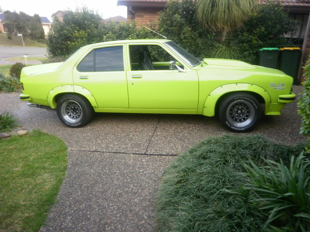

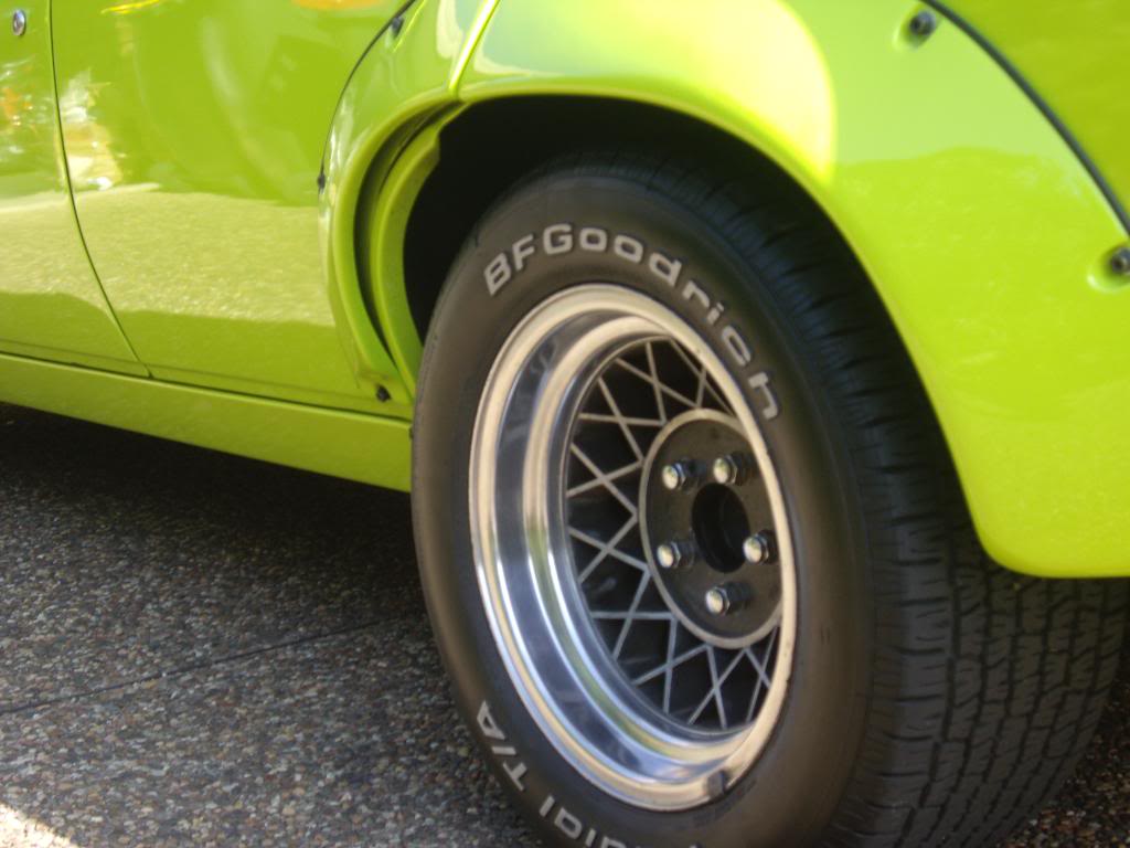

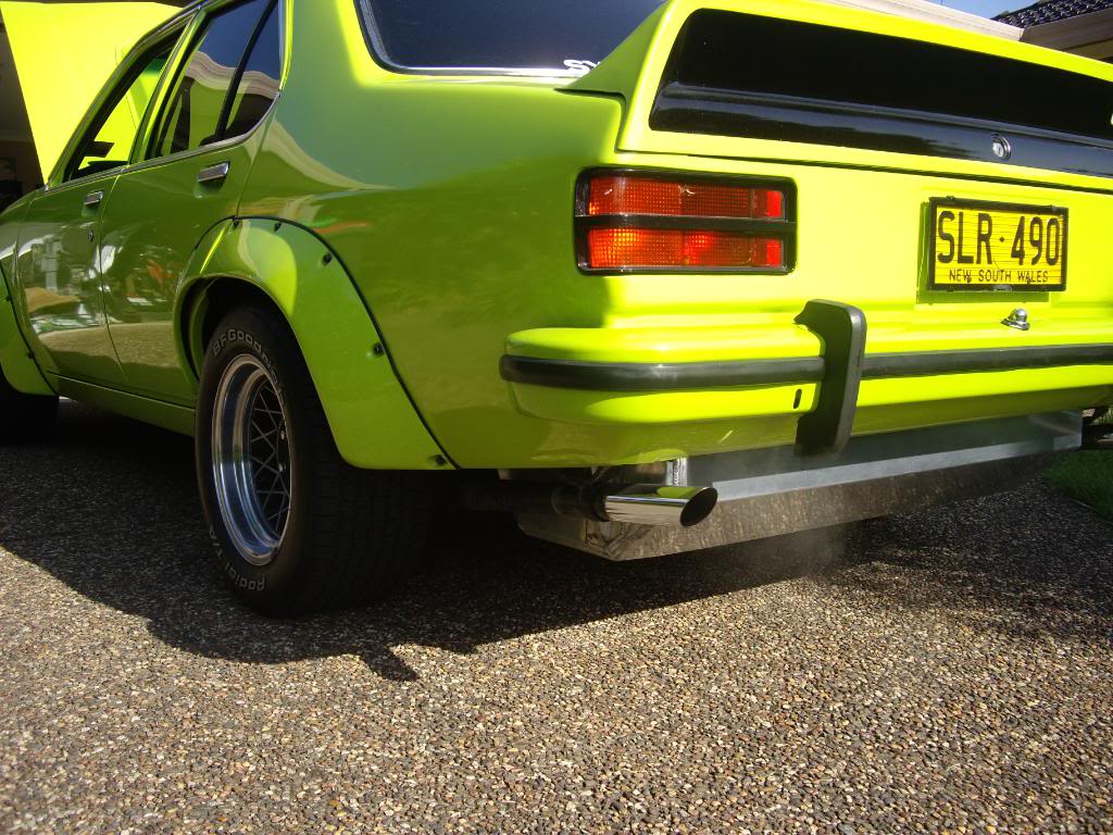

Hi,
i had 245/50/14 Bf t/a on a Hotwire 14x8 Torana stud
hope this helps

Yes lots of guard cut away .
I now have 265/50/15 and it rubs when fully loaded with fuel and passengers
Now looking at airbags inside coils to stiffen it up
look at this website it may help with your rolling diameter http://www.miata.net...e/tirecalc.html
