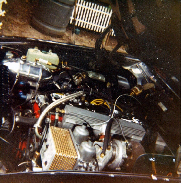

The original garret kits had the brake vacuum tapped into the carb manifold between the carbs and the turbo.. I would not even think about placing it after the turbo......
http://www.litre8.com/old_turbo6.jpg

thanks howard
i have plumbed the booster and pcv into the two bungs betwween carbbies and turbo.
i only have wastegate and boost gauge on th inlet manifold.
peter
